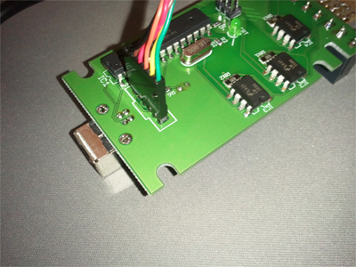

Ok, so for those that want to implement this and take advantage of the PWM Expansion Module processing capability, here is how to upload new code to the module:
1. Connect the cable according to the picture:
2. Use Arduino to upload code just like you do with RA.
