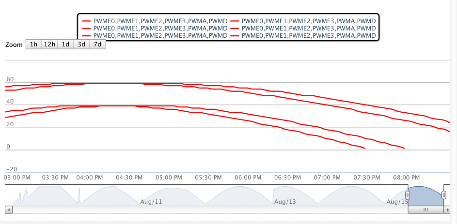

Yay, Roberto merged this in today :) Thought I would post a pic of the output. I have channel 0 and 2 defined as daylight with a 30 minute offset between them. I have channel 1 and 3 with the actinic offset applied plus the 30 minute offset between each channel. Here's what it looks like.
