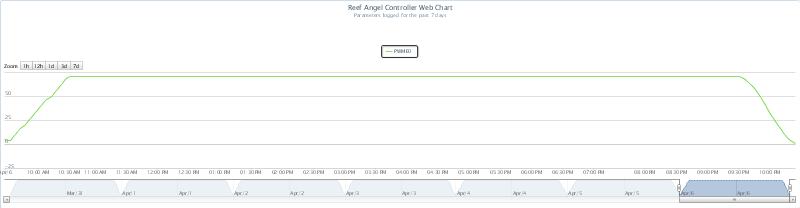

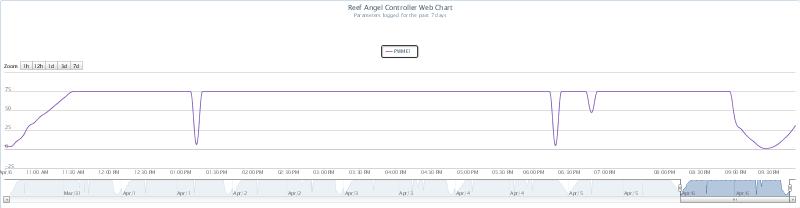

Here's the chart from last night. The lights should start dimming at 2100. Ignore the dips earlier. That was cloud code that I disabled just to make sure it wasn't interfering.
http://forum.reefangel.com/status/chart ... lter=pwme1

Interestingly, the blues on channel 0 seem to be working correctly.
http://forum.reefangel.com/status/chart ... lter=pwme0
Reef Angel Web Chart PWME0.jpg (15.99 KiB) Viewed 3726 times
