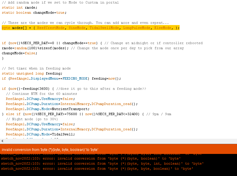

This is the first error I'm running into, see attached picture

Re: Random Wave Mode help
Yes it's definitely the extra comma. The compiler is expecting a byte value there but you're not providing one.

I took out the extra comma and its still giving me the same error: invalid conversion from 'byte(*)(byte, byte, Boolean)' to 'byte'
Take out Mode from the Mode names. Those are the functions not the "mode" so replace ReefCrestMode with ReefCrest
slm222
Joined: Wed Nov 18, 2015 9:16 pm
Post by slm222 »
ahh. That seems to have fixed it. I will try it tonight and see how it goes. Thank you very much for the help. I will report back.

heres something I just noticed. ive tried two different variations of the code.
with this code it stays in tidal swell mode

in this code it goes to random, but im trying to figure out how you stated above to change change rate to every 6 hours

any idea on why the code here would stay on sine instead of going to random ?

Well there's only a 1 in 4 chance of it and second, it's going to be the same all day. Did you add the randomseed function. You can take out the / seconds per day part and it should be more random. Also know that the portal only updates every 5 minutes

Steve's seems to just go from night time to the random code. I tried it in my code, but it seems to just stay in sine mode.

You realize you hve the schedule all setup at the end. From 7pm to 9am you are forcing sine mode. The only time you are using the random mode is between 9am and 7pm
