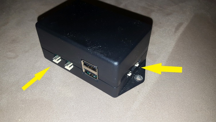

I did take the millis() check out (the parabola/slope waveforms don't change that much over a few hours) but will put it back in and experiment with working it under the full second... I'd like to work the connected channels into lightening code and I think 1 sec response is a bit too long.
Couple questions from the picture below, what are these ports and are they active?
Arrows point to ports.
Cloud Wifi Hub 2.jpg (112.71 KiB) Viewed 12374 times

The broadcast of data through the cloud server is not going to be fast enough for lightning.
If you want to implement that, you will have to program the cloud wifi hub code itself and implement the lightning code in there and just send a trigger signal to start and stop the lightning code.
If you want to do that, you will need to use the Arduino IDE with the latest dev branch of the libraries.
The header is for two temp probe and two input channels. They are enabled and are currently T4 and T5 and channel 6 and channel 7 of the I/O expansion.

Ahhh... data throughput limit is with the cloud server and not with the module.
Header for two temp probes, two I/O ports, and can accept code independently of the RA*, this module looks better and better.
