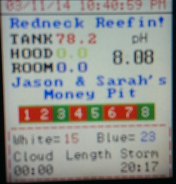

jegillis
Posts: 86
Joined: Sat Jan 04, 2014 10:26 am
Re: Custom Main Screens
Post by jegillis »
byte ActinicPWMValue=0;
byte DaylightPWMValue=0;
  byte x = 6;
  byte y = 2;
  byte t;
  char text[7];
  //static byte vtechmode=0;
  ReefAngel.LCD.DrawDate(6, 2);
  ReefAngel.LCD.Clear(COLOR_BLACK, 1, 11, 132, 11);
  ReefAngel.LCD.DrawLargeText(3,255,8,16,"Redneck Reefin!", Font8x8);
  ReefAngel.LCD.DrawLargeText(3,255,8,56,"Jason & Sarah's", Font8x8);
  ReefAngel.LCD.DrawLargeText(3,255,32,65,"Money Pit", Font8x8);
  ReefAngel.LCD.DrawText(COLOR_BLACK,255, 6, 90, "--------------------");
  ReefAngel.LCD.DrawText(COLOR_BLACK,255, 6, 126, "--------------------");
  ReefAngel.LCD.DrawText(COLOR_BLACK,255, 2, 93, "|");
  ReefAngel.LCD.DrawText(COLOR_BLACK,255, 2, 103, "|");
  ReefAngel.LCD.DrawText(COLOR_BLACK,255, 2, 113, "|");
  ReefAngel.LCD.DrawText(COLOR_BLACK,255, 2, 123, "|");
  ReefAngel.LCD.DrawText(COLOR_BLACK,255, 126, 93, "|");
  ReefAngel.LCD.DrawText(COLOR_BLACK,255, 126, 103, "|");
  ReefAngel.LCD.DrawText(COLOR_BLACK,255, 126, 113, "|");
  ReefAngel.LCD.DrawText(COLOR_BLACK,255, 126, 123, "|");
  ReefAngel.LCD.DrawText(0,255,10,30,"Display");
  ReefAngel.LCD.DrawLargeText(COLOR_BLACK, 255, 10, 40, text, Num8x16);
  ReefAngel.LCD.DrawText(0,255,100,30,"pH");
  ReefAngel.LCD.DrawLargeText(COLOR_BLACK, 255, 85, 40, text, Num8x16);
  ReefAngel.LCD.DrawOutletBox(12, 77, TempRelay);
  ReefAngel.LCD.DrawText(0,255,8,109, "CWLED");
  ReefAngel.LCD.DrawText(COLOR_BLACK,255,15,119, ReefAngel.PWM.GetDaylightValue());
  //ReefAngel.PWM.GetDaylightValue(),
  ReefAngel.LCD.DrawText(0,255,88,108, "RBLED");
  ReefAngel.LCD.DrawText(COLOR_BLACK,255,90,119, ReefAngel.PWM.GetActinicValue());
  //ReefAngel.PWM.GetActinicValue());
  //ReefAngel.LCD.DrawMonitor(15, 60, ReefAngel.Params,

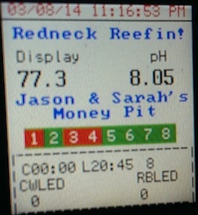

jegillis
Posts: 86
Post by jegillis »
Well that didn't last long before I had to tinker would anyone have an idea on how I could have the temps change color if they are over a set limit?
#define SIMPLE_MENU
#define NUMBERS_8x16
#define FONT_8x8
  byte x = 6;
  byte y = 2;
  byte t;
  char text[7];
  ReefAngel.LCD.DrawLargeText(3,255,8,14,"Redneck Reefin!", Font8x8);
  ReefAngel.LCD.DrawLargeText(3,255,8,55,"Jason & Sarah's", Font8x8);
  ReefAngel.LCD.DrawLargeText(3,255,32,64,"Money Pit", Font8x8);
  ReefAngel.LCD.DrawText(COLOR_RED,255, 6, 88, "--------------------");
  ReefAngel.LCD.DrawText(COLOR_RED,255, 6, 125, "--------------------");
  ReefAngel.LCD.DrawText(COLOR_RED,255, 2, 93, "|");
  ReefAngel.LCD.DrawText(COLOR_RED,255, 2, 103, "|");
  ReefAngel.LCD.DrawText(COLOR_RED,255, 2, 113, "|");
  ReefAngel.LCD.DrawText(COLOR_RED,255, 2, 123, "|");
  ReefAngel.LCD.DrawText(COLOR_RED,255, 126, 93, "|");
  ReefAngel.LCD.DrawText(COLOR_RED,255, 126, 103, "|");
  ReefAngel.LCD.DrawText(COLOR_RED,255, 126, 113, "|");
  ReefAngel.LCD.DrawText(COLOR_RED,255, 126, 123, "|");
  ReefAngel.LCD.DrawLargeText(0,255,8,25,"TANK", Font8x8);
  ReefAngel.LCD.DrawLargeText(224, 255, 42, 25, text, Font8x8);
  ReefAngel.LCD.DrawLargeText(0,255,8,35,"HOOD", Font8x8);
  ConvertNumToString(text, ReefAngel.Params.Temp[T2_PROBE], 10);
  ReefAngel.LCD.DrawLargeText(153, 255, 42, 35, text, Font8x8);
  ReefAngel.LCD.DrawLargeText(0,255,8,45,"ROOM", Font8x8);
  ConvertNumToString(text, ReefAngel.Params.Temp[T3_PROBE], 10);
  ReefAngel.LCD.DrawLargeText(66, 255, 42, 45, text, Font8x8);
  ReefAngel.LCD.DrawText(0,255,100,25,"pH");
  ReefAngel.LCD.DrawLargeText(COLOR_BLACK, 255, 85, 35, text, Num8x16);
  ReefAngel.LCD.DrawOutletBox(12, 75, TempRelay);
    ReefAngel.LCD.DrawText(0,255,8,96, "White=");
  ReefAngel.LCD.DrawText(197,255,46,96, ReefAngel.PWM.GetDaylightValue());
  //ReefAngel.PWM.GetDaylightValue()),
  ReefAngel.LCD.DrawText(0,255,72,96, "Blue=");
  ReefAngel.LCD.DrawText(3,255,106,96, ReefAngel.PWM.GetActinicValue());
    ReefAngel.Use2014Screen();  // Let's use 2014 Screen
    ReefAngel.FeedingModePorts = Port5Bit | Port6Bit;
    ReefAngel.WaterChangePorts = Port1Bit | Port5Bit | Port6Bit | Port8Bit;
    ReefAngel.LightsOnPorts = Port3Bit | Port4Bit;
    ReefAngel.OverheatShutoffPorts = Port3Bit | Port4Bit;
    ReefAngel.SingleATOLow( Port1 );
    ReefAngel.Relay.Set( Port2, !ReefAngel.Relay.Status( Port3 ) );
    ReefAngel.ActinicLights( Port3 );
    ReefAngel.DayLights( Port4 );
    ReefAngel.Wavemaker1( Port5 );
    ReefAngel.Wavemaker2( Port6 );
    ReefAngel.DosingPumpRepeat1( Port7 );
    ReefAngel.StandardFan( Port8 );
    ReefAngel.PWM.DaylightPWMSlope();
    ReefAngel.PWM.ActinicPWMSlope();
    // Calculate your regular sunrise/sunset PWM value
    ActinicPWMValue=PWMSlope(12,15,22,45,15,100,60,ActinicPWMValue);
    DaylightPWMValue=PWMSlope(13,0,22,0,15,100,60,DaylightPWMValue);
    CheckCloud();
    ReefAngel.PWM.SetActinic(ActinicPWMValue);
    ReefAngel.PWM.SetDaylight(DaylightPWMValue);
    ReefAngel.Portal( "jegillis" );
// Random Cloud/Thunderstorm effects function
void CheckCloud()
  // Change the values below to customize your cloud/storm effect
  // Frequency in days based on the day of the month - number 2 means every 2 days, for example (day 2,4,6 etc)
  // For testing purposes, you can use 1 and cause the cloud to occur everyday
#define Clouds_Every_X_Days 1
  // Percentage chance of a cloud happening today
  // For testing purposes, you can use 100 and cause the cloud to have 100% chance of happening
#define Cloud_Chance_per_Day 100
  // Minimum number of minutes for cloud duration.  Don't use max duration of less than 6
#define Min_Cloud_Duration 7
  // Maximum number of minutes for the cloud duration. Don't use max duration of more than 255
#define Max_Cloud_Duration 15
  // Minimum number of clouds that can happen per day
#define Min_Clouds_per_Day 3
  // Maximum number of clouds that can happen per day
#define Max_Clouds_per_Day 5
  // Only start the cloud effect after this setting
  // In this example, start could after 11:30am
#define Start_Cloud_After NumMins(15,00)
  // Always end the cloud effect before this setting
  // In this example, end could before 8:00pm
#define End_Cloud_Before NumMins(22,00)
  // Percentage chance of a lightning happen for every cloud
  // For testing purposes, you can use 100 and cause the lightning to have 100% chance of happening
#define Lightning_Change_per_Cloud 100
  // Note: Make sure to choose correct values that will work within your PWMSLope settings.
  // For example, in our case, we could have a max of 5 clouds per day and they could last for 50 minutes.
  // Which could mean 250 minutes of clouds. We need to make sure the PWMSlope can accomodate 250 minutes of effects or unforseen resul could happen.
    // Also, make sure that you can fit double those minutes between Start_Cloud_After and End_Cloud_Before.
  // In our example, we have 510 minutes between Start_Cloud_After and End_Cloud_Before, so double the 250 minutes (or 500 minutes) can fit in that 510 minutes window.
    // It's a tight fit, but it did.
  //#define printdebug // Uncomment this for debug print on Serial Monitor window
  #define forcecloudcalculation // Uncomment this to force the cloud calculation to happen in the boot process.
  // Change the values above to customize your cloud/storm effect
  // Do not change anything below here
  static byte cloudchance=255;
  static byte cloudduration=0;
  static int cloudstart=0;
  static byte numclouds=0;
  static byte lightningchance=0;
  static byte cloudindex=0;
  static byte lightningstatus=0;
  static int LastNumMins=0;
  // Every day at midnight, we check for chance of cloud happening today
  if (hour()==0 && minute()==0 && second()==0) cloudchance=255;
#ifdef forcecloudcalculation
    if (cloudchance==255)
#else
    if (hour()==0 && minute()==0 && second()==1 && cloudchance==255)
#endif
      //Pick a random number between 0 and 99
      cloudchance=random(100);
      // if picked number is greater than Cloud_Chance_per_Day, we will not have clouds today
      if (cloudchance>Cloud_Chance_per_Day) cloudchance=0;
      // Check if today is day for clouds.
      if ((day()%Clouds_Every_X_Days)!=0) cloudchance=0;
      // If we have cloud today
      if (cloudchance)
        // pick a random number for number of clouds between Min_Clouds_per_Day and Max_Clouds_per_Day
        numclouds=random(Min_Clouds_per_Day,Max_Clouds_per_Day);
        // pick the time that the first cloud will start
        // the range is calculated between Start_Cloud_After and the even distribuition of clouds on this day.
        cloudstart=random(Start_Cloud_After,Start_Cloud_After+((End_Cloud_Before-Start_Cloud_After)/(numclouds*2)));
        // pick a random number for the cloud duration of first cloud.
        cloudduration=random(Min_Cloud_Duration,Max_Cloud_Duration);
        lightningchance=random(100);
        // if picked number is greater than Lightning_Change_per_Cloud, we will not have lightning today
        if (lightningchance>Lightning_Change_per_Cloud) lightningchance=0;
  // Now that we have all the parameters for the cloud, let's create the effect
  if (cloudchance)
    //is it time for cloud yet?
    if (NumMins(hour(),minute())>=cloudstart && NumMins(hour(),minute())<(cloudstart+cloudduration))
      DaylightPWMValue=ReversePWMSlope(cloudstart,cloudstart+cloudduration,DaylightPWMValue,15,180);
      if (lightningchance && (NumMins(hour(),minute())==(cloudstart+(cloudduration/2))) && second()<5)
        if (random(100)<20) lightningstatus=1;
        else lightningstatus=0;
        if (lightningstatus)
          DaylightPWMValue=100;
          ActinicPWMValue=100;
          DaylightPWMValue=0;
          ActinicPWMValue=15;
        delay(1);
    if (NumMins(hour(),minute())>(cloudstart+cloudduration))
      cloudindex++;
      if (cloudindex < numclouds)
        cloudstart=random(Start_Cloud_After+(((End_Cloud_Before-Start_Cloud_After)/(numclouds*2))*cloudindex*2),(Start_Cloud_After+(((End_Cloud_Before-Start_Cloud_After)/(numclouds*2))*cloudindex*2))+((End_Cloud_Before-Start_Cloud_After)/(numclouds*2)));
  if (LastNumMins!=NumMins(hour(),minute()))
    LastNumMins=NumMins(hour(),minute());
    ReefAngel.LCD.Clear(255,0,120,132,132);
    ReefAngel.LCD.DrawText(0,255,8,108,"Cloud");
    ReefAngel.LCD.DrawText(0,255,8,118,"00:00");
    ReefAngel.LCD.DrawText(0,255,90,108,"Storm");
    ReefAngel.LCD.DrawText(0,255,48,108,"Length");
    ReefAngel.LCD.DrawText(0,255,90,118,"00:00");
    if (cloudchance && (NumMins(hour(),minute())<cloudstart))
      int x=0;
      if ((cloudstart/60)>=10) x=8; else x=14;
      ReefAngel.LCD.DrawText(37,255,x,118,(cloudstart/60));
      if ((cloudstart%60)>=10) x=58; else x=64;
      ReefAngel.LCD.DrawText(37,255,x,118,(cloudstart%60));
    if (lightningchance)
      int x=0;
      if (((cloudstart+(cloudduration/2))/60)>=10) x=90; else x=96;
      ReefAngel.LCD.DrawText(37,255,x,118,((cloudstart+(cloudduration/2))/60));
      if (((cloudstart+(cloudduration/2))%60)>=10) x=108; else x=114;
      ReefAngel.LCD.DrawText(37,255,x,118,((cloudstart+(cloudduration/2))%60));
byte ReversePWMSlope(long cstart,long cend,byte PWMStart,byte PWMEnd, byte clength)
  long n=elapsedSecsToday(now());
  cstart*=60;
  cend*=60;
  if (n<cstart) return PWMStart;
  if (n>=cstart && n<=(cstart+clength)) return map(n,cstart,cstart+clength,PWMStart,PWMEnd);
  if (n>(cstart+clength) && n<(cend-clength)) return PWMEnd;
  if (n>=(cend-clength) && n<=cend) return map(n,cend-clength,cend,PWMEnd,PWMStart);
  if (n>cend) return PWMStart;

Got my tank going and started diving in further into my Reef Angel.
Here is what Display looks like, I modified reefer's code. I added the center channel and added code to display the offset speed of the antisync pump
//Custom Main, Graph & Menu
static unsigned long PumpSpeed = InternalMemory.DCPumpSpeed_read(); //Sets Value to pump speed
static int PumpOffset = (PumpSpeed*1.10); //Change Value to match AntiSyncOffset value
void DrawCustomMain() {
  byte x = 6;
  byte y = 2;
  byte t;
  char text[7];
 ReefAngel.LCD.DrawLargeText(COLOR_BLACK,COLOR_WHITE, 6, 2, " GugsJr's Reef");
 ReefAngel.LCD.DrawDate(6, 118);
 ReefAngel.LCD.Clear(COLOR_BLACK, 1, 17, 132, 17);
  ReefAngel.LCD.DrawLargeText(COLOR_BLUE,COLOR_WHITE, 24,16,"Jebao Mode:");
       if  (now()%SECS_PER_DAY<52200|| now()%SECS_PER_DAY >=1800) ReefAngel.LCD.DrawLargeText(COLOR_MAGENTA,255,28,26,"Night Mode");
  else if  (InternalMemory.DCPumpMode_read()==Lagoon) ReefAngel.LCD.DrawLargeText(COLOR_MAGENTA,255,42,26,"Lagoon");
  else if  (InternalMemory.DCPumpMode_read()==ReefCrest) ReefAngel.LCD.DrawLargeText(COLOR_MAGENTA,255,25,26,"Reef Crest");
  else if  (InternalMemory.DCPumpMode_read()==ShortPulse) ReefAngel.LCD.DrawLargeText(COLOR_MAGENTA,255,22,26,"Short Pulse");
  else if  (InternalMemory.DCPumpMode_read()==LongPulse) ReefAngel.LCD.DrawLargeText(COLOR_MAGENTA,255,25,26,"Long Pulse");
  else if  (InternalMemory.DCPumpMode_read()==NutrientTransport) ReefAngel.LCD.DrawLargeText(COLOR_MAGENTA,255,8,26,"Nutrient Trnsp.");
  else if  (InternalMemory.DCPumpMode_read()==TidalSwell) ReefAngel.LCD.DrawLargeText(COLOR_MAGENTA,255,23,26,"Tidal Swell");
  else if  (InternalMemory.DCPumpMode_read()==Custom) ReefAngel.LCD.DrawLargeText(COLOR_MAGENTA,255,23,26,"Custom");
  else if  (InternalMemory.DCPumpMode_read()==Else) ReefAngel.LCD.DrawLargeText(COLOR_MAGENTA,255,23,26,"Tidal Else");
  else if  (InternalMemory.DCPumpMode_read()==Sine) ReefAngel.LCD.DrawLargeText(COLOR_MAGENTA,255,23,26,"Sine");
  else if  (InternalMemory.DCPumpMode_read()==Gyre) ReefAngel.LCD.DrawLargeText(COLOR_MAGENTA,255,23,26,"Gyre");
  else if  (InternalMemory.DCPumpMode_read()== Constant) ReefAngel.LCD.DrawLargeText(COLOR_MAGENTA,255,35,27,"Constant");
  ReefAngel.LCD.DrawLargeText(0,255,17,36,"Display");
  ReefAngel.LCD.DrawLargeText(0,255,17,49,"Temp");
  ReefAngel.LCD.DrawHugeText(COLOR_RED, 255, 12, 65, text, Num12x16);
  ReefAngel.LCD.DrawLargeText(0,255,100,45,"pH");
  ReefAngel.LCD.DrawLargeText(COLOR_BLUE, 255, 89, 65, text, Num8x8);
  ReefAngel.LCD.DrawText(COLOR_CORNFLOWERBLUE,255,5,80, "Jebao");
  ReefAngel.LCD.DrawText(COLOR_CORNFLOWERBLUE,255,10,89, "Left");
  ReefAngel.LCD.DrawText(COLOR_BLACK,255,16,100, InternalMemory.DCPumpSpeed_read());
  ReefAngel.LCD.DrawText(COLOR_CORNFLOWERBLUE,255,50,80, "Jebao");
  ReefAngel.LCD.DrawText(COLOR_CORNFLOWERBLUE,255,49,89, "Center");
  ReefAngel.LCD.DrawText(COLOR_BLACK,255,59,100, PumpOffset);
  ReefAngel.LCD.DrawText(COLOR_CORNFLOWERBLUE,255,93,80, "Jebao");
  ReefAngel.LCD.DrawText(COLOR_CORNFLOWERBLUE,255,88,89, " Right");
  ReefAngel.LCD.DrawText(COLOR_BLACK,255,100,100, InternalMemory.DCPumpSpeed_read());
