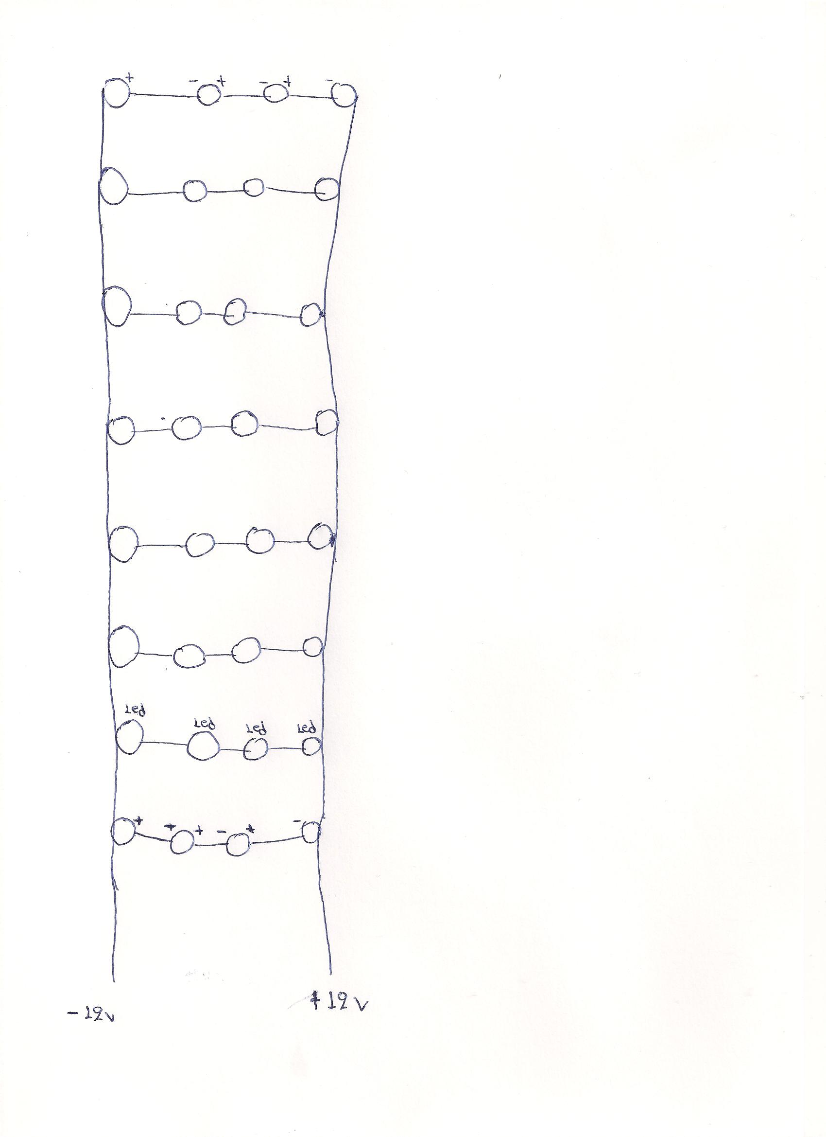

I do not know what is the problem?? I Buy a new led driver (Mean Well LPF 60D 12) and I have the same problem......NO DIMMING. if i buy the RA dimming expansion it will be ok? I bored to give my money with no resolts....
Re: Preloaded code and change...
Can you post a diagram of how you connected your led strings to the driver?
60W on 12V is a lot of current.

I hope to be clear the diagram.
- this is the diagram.
- led conection.jpg (134.58 KiB) Viewed 8318 times

Does it dim if you use the AA and 9V battery?
Did you try the potentiometer option too?
Can you measure the voltage on the RA dimming ports?
At 0% the AP out put 0,3 V and the led driver 2,6 V. At 100% the AP out put 9,8 V and the led driver 11,8 V. I don't try potentiometer or AA batteries . Is the second led driver with this problem . What I am doing wrong ?
Looks like your dimming channels are working fine.
I'm not so sure the drivers were supposed to go down in voltage like that.

I check the driver with AA 1,5 V and 9V batteries and again the same voltage to the led (11,7) V.
The voltage won't change.
It needs to be at about what you are seeing or it would go below the forward voltage and you wouldn't have enough voltage to power the LEDs.
What needs to change is the current. As you apply more or less voltage on the dimming input, the average current increases or decreases making it go brighter or darker.
Most people use only one string or 2 max. You are the first one doing it with several strings.
I would suggest you contact the manufacturer of the driver and check with them.
