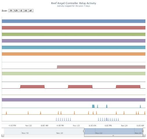

The doser did not turn on today? Any thoughts?
Vinegar dosing relay is the last blue graph
///Code to make Vinegar Dosing Work 4 mins
  ReefAngel.DosingPumpRepeat(Box1_Port8,0,60,240);
///Do not turn on Vinegar if lights are off
  if (hour()<=9 || hour()>21) {
    ReefAngel.Relay.Off(Box1_Port8);
Paul_Velasco

You will have to watch the dosing pump to see if it starts and runs at the desired time. I was told that if the relay is not running for at least 5 minutes it may not show up in the charts on the portal. At least that is what I have encountered when I run my dosing pumps for 140 seconds. Sometimes they show up in the charts sometimes they don't.
Re: Carbon Vodka Dosing
The first arg is the port, second is the offset from midnight. 3rd is runtime and last is the repeat time. As mudcat said the portal only gets updates every 5 minutes starting at last reboot. Sometimes that might capture your dosing pump, sometimes not.

Starting at 2PM want to start at 9AM? Having the portal send me an email everytime the relay triggers. Emails start at 2PM.
Any ideas?
Again the portal cannot send you reliable notifications like that. Your best method would be to use WiFiAlert to send an alert immediately. Are you using the first or second line that you posted above? I would recommend the second if you want it to start at 9am.

Here's a way you can track it. This is for 2 pumps. The way this works is when your dosing pump relays come on, this turns on relays in a "ghost" expansion relay for 5 minutes so the portal can track them. It is only good for seeing that the relays came on, not for the actual length of time they were on.
