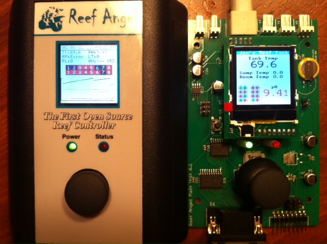

Auxilliary LCD monitor
Re: Auxilliary LCD monitor
Yes, just 4 lines.
The pinout of the HDDB15 is:
1-Relay1
2-Relay3
3-Relay5
4-Relay7
5-Relay8
6-Relay2
7-Relay4
8-Relay6
9-Not Connected
10-GND
11-Actinic PWM
12-Daylight PWM
13-SDA
14-SCL
15-+5VDC
So, all you need is make a cable and connect the SDA to D- and SCL to D+ and the power lines (VCC and GND)
Check D- and D+ pinout here:
Thanks Roberto.  I used the same USB pinouts on the sound board I made to link as a module, but the HDDB15 pinout is helpful.  Thanks.  When I was asking about 4 lines, I was thinking you could upload code into the temp port connector, but I think that is just for power you still have to connect the TTL serial cable to load code right?
-Jon
						-Jon
Correct. Just power.
You still need the USB-TTL cable to upload the code.
						- jsclownfish
 - Posts: 375
 - Joined: Mon Oct 24, 2011 7:52 pm
 - Location: Saint Louis
Your suggestion seems to work great.
   I made a cable last night and gave it a try.  Curiously, the auxillary monitor doesn't seem to sleep, but the main does.  I thought it was the Refresh function, but if that is removed the auxillary keeps resetting over and over again.
-Jon
-Jon

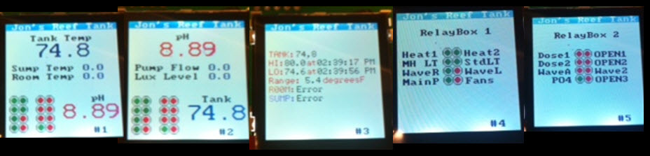

   It doesn't really require an RA+ but it will require either a second main board or a second LCD connected to an Arduino controller.
I had an idea today. Since the joystick is there and the auxLCD is only for display purposes, I might be able to toggle between two screen formats to show more data. My hope was to use the joystick to trigger it, but a simple delay between screens would be OK. The problem is that using any delay or this code...
causes the screen to reset and the alert light to blink.  At best I could change a little bit temporarily on the joystick button press function alone.  Any ideas why it is resetting?  I tried the clearscreen function and the refresh function as well.  Same issue.
Thanks for your help,
Jon
bool bDone = false;
do
// wait indefinitely for a button press
delay(200);
if ( ReefAngel.Joystick.IsButtonPressed() )
bDone = true;
} while ( ! bDone );
  // Tell the controller to cleanup and return to the main screen
  //ReefAngel.DisplayedMenu = RETURN_MAIN_MODE;
// To return to the menu instead, comment out the above line and use
// this line instead
Soundsend (11,100);
ReefAngel.DisplayedMenu = ALT_SCREEN_MODE;Thanks for your help,
Jon
It's the WDT that is kicking in.
You need this:
The WDT needs to receive a reset within 1 second. If it doesn't receive the signal, it will assume that something is wrong and will reset to prevent lockup.
							You need this:
wdt_reset();
						- jsclownfish
 - Posts: 375
yep, that did the trick.
  (I just removed that from the features file)  The screens switch over nicely now on the press of the button.  I still however can't get the data to refresh once I've entered the loop.  I have a similar issue with the custom data screens.  http://forum.reefangel.com/viewtopic.php?f=12&t=645  I tried to simply copy the void receiveEvent function in the loop, but couldn't get that to work.
Jon

  switch (ScreenID)
    case 0:
      // Draw Screen 0
      break;
    case 1:
      // Draw Screen 1
      break;

Wow, that works great!
  I can switch data screens and the data keeps updating nicely.  Now I'm dreaming about all the different screens I could display.
   I need to work out how to update between screens though.  As long as the format is the same and writes over the last screen it works.  But if it is a different format and I try to clear the screen, the loop causes the screen to look like it is flashing.
-Jon

This is so cool! I hadn't really envisioned this aspect of having an auxillary monitor that doesn't bear the weight of the other controller functions. I was messing around with it today and put this group of screens together. It easily moves from one to the next and keeps the data updating. (since I don't have all the sensors hooked up on these there are some of the 0's or Errors on the display)
Check it out.... Now I'm looking forward to really thinking about what each screen should look like and how to display the data. That should keep me busy for awhile.
Thanks for all the help!

  ReefAngel.Init();  //Initialize controller and start web banner timer
  Wire.begin(10); // I2C address 10
  Wire.onReceive(receiveEvent);
  ReefAngel.Timer[LCD_TIMER].SetInterval(120);

  switch (ScreenID)
  case 0:  //Initial first screen
    ReefAngel.Refresh();

    DrawCircleBox (56,46,TempRelay);
    ReefAngel.LCD.DrawLargeText(0,255,27,20,"RelayBox 1", Font8x8);
    ReefAngel.LCD.DrawLargeText(0,255,7,44,"Heat1", Font8x8);
    ReefAngel.LCD.DrawLargeText(0,255,7,54,"MH LT", Font8x8);
    ReefAngel.LCD.DrawLargeText(0,255,7,64,"WaveR", Font8x8);
    ReefAngel.LCD.DrawLargeText(0,255,7,74,"MainP", Font8x8);
    ReefAngel.LCD.DrawLargeText(0,255,75,44,"Heat2", Font8x8);
    ReefAngel.LCD.DrawLargeText(0,255,75,54,"StdLT", Font8x8);
    ReefAngel.LCD.DrawLargeText(0,255,75,64,"WaveL", Font8x8);
    ReefAngel.LCD.DrawLargeText(0,255,75,74,"Fans", Font8x8);
    break;
  case 4:  //relay box key
    ReefAngel.LCD.DrawLargeText(COLOR_WHITE, COLOR_CORNFLOWERBLUE, 0, 0, "                 ", Font8x8); //Top Banner
    ReefAngel.LCD.DrawLargeText(COLOR_WHITE, COLOR_CORNFLOWERBLUE, 0, 1, " Jon's Reef Tank ", Font8x8); //Top Banner
    ReefAngel.LCD.DrawLargeText(0,255,100,120,"#5", Font8x8);
    DrawCircleBox (56,46,TempRelay2);
    ReefAngel.LCD.DrawLargeText(0,255,27,20,"RelayBox 2", Font8x8);
    ReefAngel.LCD.DrawLargeText(0,255,7,44,"Dose1", Font8x8);
    ReefAngel.LCD.DrawLargeText(0,255,7,54,"Dose2", Font8x8);
    ReefAngel.LCD.DrawLargeText(0,255,7,64,"WaveA", Font8x8);
    ReefAngel.LCD.DrawLargeText(0,255,7,74,"  PO4", Font8x8);
    ReefAngel.LCD.DrawLargeText(0,255,75,44,"OPEN1", Font8x8);
    ReefAngel.LCD.DrawLargeText(0,255,75,54,"OPEN2", Font8x8);
    ReefAngel.LCD.DrawLargeText(0,255,75,64,"Wave2", Font8x8);
    ReefAngel.LCD.DrawLargeText(0,255,75,74,"OPEN3", Font8x8);
    break;
void receiveEvent(int howMany)
  if (howMany==13)  // Our custom protocol is 13 bytes
    byte cmd1, cmd2, cmd3, cmd4, cmd5, cmd6, cmd7, cmd8, cmd9, cmd10, cmd11,cmd12,cmd13;
      cmd1=Wire.receive();
      cmd2=Wire.receive();
      cmd3=Wire.receive();
      cmd4=Wire.receive();
      cmd5=Wire.receive();
      cmd6=Wire.receive();
      cmd7=Wire.receive();
      cmd8=Wire.receive();
      cmd9=Wire.receive();
      cmd10=Wire.receive();
      cmd11=Wire.receive();
      cmd12=Wire.receive();
      cmd13=Wire.receive();
    if (cmd1=='$' && cmd2=='$' && cmd3=='$') // the first 3 bytes of the custom protocol are $$$ to ensure it's coming from RA
    maintemp=(cmd4<<8)+cmd5;
    sumptemp=(cmd6<<8)+cmd7;
    roomtemp=(cmd8<<8)+cmd9;
    ph=(cmd10<<8)+cmd11;
    TempRelay=cmd12;
    TempRelay2=cmd13;
    for (int a=0;a<howMany;a++)
      Wire.receive(); // if the number of bytes is not 13, discard everything

I do as well. I killed a temp extension cable this weekend doing this. Roberto, is there some secret to this problem? Thx in advance.jsclownfish wrote:I also have trouble with the temp connectors getting them off and on without messing them up. -Jon
Ross
Roscoe's Reefs  - Starting Over Again:
You can try filing the connector so it doesn't get caught so tight or pull the connector and not the cable.
Can we have more pictures of your multiple display? I mean how do you connect everythings?
Thx and good work !
I hope We will have touch screen in the future ^^ !
							Thx and good work !

I'll post some pics soon, the only 'extra' hardware is a main head unit RA+ connected to the original RA (same enclosure and all).   The one piece of DIY, is the cable.  I spliced an old serial cable and USB cable together according to the pinout Roberto advised here, http://forum.reefangel.com/viewtopic.ph ... 2&start=10.   You only need 4 of the wires from the serial connection (on the auxillary) to connect to a USB line for I2C communication.
The serial HDDB15 pins needed are:
10-GND
13-SDA
14-SCL
15-+5VDC
These then connect to the USB locations here: http://pinouts.ru/Slots/USB_pinout.shtml
I needed a conductivity meter to make sure I had the right pins and wires.
-Jon

Jon:  Did you ever post pics on your set up somewhere on the forums?  I just ordered a RA+ upgrade board and now of course I am interested in using the old board like you have here....Seeing your connections would help me figure if I have enough "tech potential" to pull it off! thanks
Rob

I'm not sure what your looking for in the way of pictures.  The only thing I had to set up to make it work was the DIY cable above.   Let me know and I can try to take a picture.
Jon

Well, just a pic of the controllers connected together, so we can see what is connected to what, and how you have this all mounted and placed in your system...
Oh, and was it hard in making the pde to ido file switch? Did you have to change any code in the switch over, or is what you have posted in this thread still working?

You can see pictures of the code and the set-up here http://forum.reefangel.com/viewtopic.php?f=11&t=923, and here it is on the tank.
Not terribly exciting, but you can see I use one of those car mobile phone holders for the main controller in the stand and I have the 2nd unit attached with velcro to the outside of the stand. That let's me pull it off and look at the different screens a bit more easily. You can't see the expansion unit in the picture, but it is next to the one you can see on the side wall of the stand. Lastly, you'll also notice the back-up power supply to notify me if the power goes out. I used this method http://forum.reefangel.com/viewtopic.php?f=2&t=1239and it seems to work well.
-Jon

	{// Screensaver timeout expired
	ReefAngel.LCD.BacklightOff();
  if ( ReefAngel.Joystick.IsButtonPressed())
	{// turn the backlight on
	ReefAngel.LCD.BacklightOn();
  // TODO check Timer[LCD_TIMER] code
  if ( ReefAngel.Timer[LCD_TIMER].Trigger == 0 )
	ReefAngel.Timer[LCD_TIMER].Start();
	return;
	}// update the min and max temps
  if (now()%86400==0)
    minTemp=maintemp;
    maxTemp=maintemp;
  if (maintemp<minTemp)
    minTemp=maintemp;
    tsmin=now();
  if (maintemp>maxTemp)
    maxTemp=maintemp;
    tsmax=now();
  // update the min and max pH
if (now()%86400==0)
  minPH=ph;
  maxPH=ph;
if (ph<minPH)
  minPH=ph;
  PHmin=now();
if (ph>maxPH)
  maxPH=ph;
  PHmax=now();
  if (ReefAngel.Joystick.IsLeft() || ReefAngel.Joystick.IsDown())
    ReefAngel.ClearScreen(DefaultBGColor);
    ScreenID--;
  if (ReefAngel.Joystick.IsRight() || ReefAngel.Joystick.IsUp())
    ScreenID++;
  if (ScreenID<0) ScreenID=NumScreens;
  if (ScreenID>=NumScreens) ScreenID=0;
  switch (ScreenID)
    ReefAngel.LCD.DrawLargeText(0,255,100,120,"#1", Font8x8);
    // Display Temp Text
    ReefAngel.LCD.DrawLargeText(0,255,30,15,"Tank Temp", Font8x8);
    // Display the T1 temp
    char text[7];
    ConvertNumToString(text, maintemp, 10);
    ReefAngel.LCD.Clear(255, 35, 25, 50, 60);
    if (maintemp>830) ReefAngel.LCD.DrawHugeNumbers(COLOR_RED, 255, 35, 25, text);
    else if (maintemp>830) ReefAngel.LCD.DrawHugeNumbers(COLOR_ORANGE, 255, 35, 25, text);
    else ReefAngel.LCD.DrawHugeNumbers(COLOR_MIDNIGHTBLUE, 255, 35, 25, text);
    // Display pH Text
    ReefAngel.LCD.DrawLargeText(0,255,82,85,"  pH  ", Font8x8);
    // Display pH Value
    ConvertNumToString(text, ph, 100);
    ReefAngel.LCD.Clear(255, 65, 95, 132, 115);
    if (ph>840 || ph<790) ReefAngel.LCD.DrawHugeNumbers(COLOR_RED, 255, 65, 95, text);
    else if (ph>830 || ph<800) ReefAngel.LCD.DrawHugeNumbers(COLOR_ORANGE, 255, 65, 95, text);
    else ReefAngel.LCD.DrawHugeNumbers(COLOR_MIDNIGHTBLUE, 255, 65, 95, text);
    // Display Sump Temp
    ReefAngel.LCD.DrawLargeText(0,255,8,50,"Sump Temp", Font8x8);
    ReefAngel.LCD.Clear(255, 90, 50, 132, 60);
    ConvertNumToString(text, sumptemp, 10);
    ReefAngel.LCD.DrawLargeText(COLOR_MIDNIGHTBLUE, 255, 90, 50, text, Num8x8);
    // Display Room Temp
    ReefAngel.LCD.DrawLargeText(0,255,8,60,"Room Temp", Font8x8);
    ReefAngel.LCD.Clear(255, 90, 60, 132, 70);
    ConvertNumToString(text, roomtemp, 10);
    ReefAngel.LCD.DrawLargeText(COLOR_MIDNIGHTBLUE, 255, 90, 60, text, Num8x8);
    DrawCircleBox (10,90,TempRelay);
    DrawCircleBox (40,90,TempRelay2);
    break;
  case 1:  //same as first screen with position changes
    ReefAngel.LCD.DrawLargeText(0,255,100,120,"#2", Font8x8);
    ReefAngel.LCD.DrawLargeText(0,255,30,15,"   pH    ", Font8x8);
    ReefAngel.LCD.Clear(255, 35, 25, 50, 50);
    if (ph>830) ReefAngel.LCD.DrawHugeNumbers(COLOR_RED, 255, 35, 25, text);
    else if (ph>830) ReefAngel.LCD.DrawHugeNumbers(COLOR_ORANGE, 255, 35, 25, text);
    // Display pH Text
    ReefAngel.LCD.DrawLargeText(0,255,25,105,"Tank", Font8x8);
    // Display pH Value
    if (maintemp>840 || ph<790) ReefAngel.LCD.DrawHugeNumbers(COLOR_RED, 255, 65, 95, text);
    else if (maintemp>830 || ph<800) ReefAngel.LCD.DrawHugeNumbers(COLOR_ORANGE, 255, 65, 95, text);
    // Display Flow0
    ReefAngel.LCD.DrawLargeText(0,255,8,50,"Pump1Flow", Font8x8);
    ConvertNumToString(text, flow0, 10);
    // Display Flow1
    ReefAngel.LCD.DrawLargeText(0,255,8,60,"Pump2Flow", Font8x8);
    ConvertNumToString(text, flow1, 10);
    // Display light level
    ReefAngel.LCD.DrawLargeText(0,255,8,70,"Moonlight", Font8x8);
    ReefAngel.LCD.Clear(255, 90, 70, 132, 90);
    ConvertNumToString(text, moonlight, 1);
    ReefAngel.LCD.DrawLargeText(COLOR_MIDNIGHTBLUE, 255, 90, 70, text, Num8x8);
// moonphase------------------------------------------------------------
  YY = (year()) - floor((12 - (month())) / 10);
  MM = (month()) + 9;
  if (MM >= 12)
    MM = MM - 12;
  K1 = floor(365.25 * (YY + 4712));
  K2 = floor(30.6 * MM + 0.5);
  K3 = floor(floor((YY / 100) + 49) * 0.75) - 38;
  JD = K1 + K2 + (day()) + 59;
  if (JD > 2299160)
    JD = JD - K3;
  IP = (JD - 2451550.1) / 29.530588853;
  IP = IP - floor(IP);
  if (IP < 0)
    IP = IP + 1;
  AG = IP*29.53;
  if (AG < 1.84) ReefAngel.LCD.DrawLargeText(DPColor,DefaultBGColor, 5, 80,"New", Font8x8);
  else if (AG < 5.53) ReefAngel.LCD.DrawLargeText(DPColor,DefaultBGColor, 5, 80,"Waxing Crescent", Font8x8);
  else if (AG < 9.92) ReefAngel.LCD.DrawLargeText(DPColor,DefaultBGColor, 5, 80,"First Quarter", Font8x8);
  else if (AG < 12.91) ReefAngel.LCD.DrawLargeText(DPColor,DefaultBGColor, 5, 80,"Waxing Gibbous", Font8x8);
  else if (AG < 16.61) ReefAngel.LCD.DrawLargeText(DPColor,DefaultBGColor, 5, 80,"Full", Font8x8);
  else if (AG < 20.30) ReefAngel.LCD.DrawLargeText(DPColor,DefaultBGColor, 5, 80,"Waning gibbous", Font8x8);
  else if (AG < 23.99) ReefAngel.LCD.DrawLargeText(DPColor,DefaultBGColor, 5, 80,"Last Quarter", Font8x8);
  else if (AG < 27.68) ReefAngel.LCD.DrawLargeText(DPColor,DefaultBGColor, 5, 80,"Waning Crescent", Font8x8);
  else  ReefAngel.LCD.DrawLargeText(DPColor,DefaultBGColor, 5, 80,"New") ;
    break;
  case 2:  //Temperature detail screen with sump and room temp, 24 hr. max/min, time stamps, and graph
    ReefAngel.LCD.DrawLargeText(0,255,100,120,"#3", Font8x8);
    ReefAngel.LCD.DrawLargeText(0,255,10,15,"Temp Details", Font8x8);
    ReefAngel.LCD.DrawText(T1TempColor,DefaultBGColor,5,33,"TANK:");
    ReefAngel.LCD.DrawSingleMonitor(maintemp, COLOR_BLACK, 36, 33, 10);
    ReefAngel.LCD.DrawText(T1TempColor,DefaultBGColor,5,43,"HI:");
    ReefAngel.LCD.DrawSingleMonitor(maxTemp, 0, 23, 43, 10);
    ReefAngel.LCD.DrawText(T1TempColor,DefaultBGColor,48,43,"at");
    DrawTime(60,43,0, COLOR_WHITE,tsmax);
    ReefAngel.LCD.DrawText(T1TempColor,DefaultBGColor,5,53,"LO:");
    ReefAngel.LCD.DrawSingleMonitor(minTemp, 0, 23, 53, 10);
    ReefAngel.LCD.DrawText(T1TempColor,DefaultBGColor,48,53,"at");
    DrawTime(60,53,0,COLOR_WHITE, tsmin);
    ReefAngel.LCD.DrawText(T1TempColor,DefaultBGColor,5,63,"Range:");
    ReefAngel.LCD.DrawSingleMonitor((maxTemp-minTemp), COLOR_BLACK, 46, 63, 10);
    ReefAngel.LCD.DrawText(T1TempColor,DefaultBGColor,69,63,"degreesF");
    ReefAngel.LCD.DrawText(T1TempColor,DefaultBGColor,5,73,"Avg:");
    DrawDailyAvg(maintemp, COLOR_BLACK, 43, 73, 1);
    ReefAngel.LCD.DrawText(T1TempColor,DefaultBGColor,5,83,"WeeklyAvg:");
    DrawWeeklyAvg(12,maintemp, COLOR_BLACK, 66, 83, 1);
    ReefAngel.LCD.DrawText(T1TempColor,DefaultBGColor, 86,83,"at noon");
    ReefAngel.LCD.DrawText(T2TempColor,DefaultBGColor, 5 ,93,"R00M:");
    ReefAngel.LCD.DrawSingleMonitor(roomtemp, COLOR_BLACK, 36, 93, 10);
    ReefAngel.LCD.DrawText(T3TempColor,DefaultBGColor, 5, 103,"SUMP:");
    ReefAngel.LCD.DrawSingleMonitor(sumptemp, COLOR_BLACK, 36, 103, 10);
    break;
  case 3:  //pH details
    ReefAngel.LCD.DrawLargeText(0,255,100,120,"#4", Font8x8);
    ReefAngel.LCD.DrawLargeText(0,255,20,15,"pH Details", Font8x8);
    ReefAngel.LCD.DrawText(PHColor,DefaultBGColor,5,33,"pH:");
    ReefAngel.LCD.DrawSingleMonitor(ph, COLOR_BLACK, 36, 33, 100);
    ReefAngel.LCD.DrawText(PHColor,DefaultBGColor,5,43,"HI:");
    ReefAngel.LCD.DrawSingleMonitor(maxPH, 0, 23, 43, 100);
    ReefAngel.LCD.DrawText(PHColor,DefaultBGColor,48,43,"at");
    DrawTime(60,43,0, COLOR_WHITE,PHmax);
    ReefAngel.LCD.DrawText(PHColor,DefaultBGColor,5,53,"LO:");
    ReefAngel.LCD.DrawSingleMonitor(minPH, 0, 23, 53, 100);
    ReefAngel.LCD.DrawText(PHColor,DefaultBGColor,48,53,"at");
    DrawTime(60,53,0,COLOR_WHITE, PHmin);
    ReefAngel.LCD.DrawText(PHColor,DefaultBGColor,5,63,"Range:");
    ReefAngel.LCD.DrawSingleMonitor((maxPH-minPH), COLOR_BLACK, 46, 63, 100);
    ReefAngel.LCD.DrawText(PHColor,DefaultBGColor,5,73,"Avg:");
    DrawDailyAvg(ph, COLOR_BLACK, 43, 73, 100);
    ReefAngel.LCD.DrawText(PHColor,DefaultBGColor,5,83,"WeeklyAvg:");
    DrawWeeklyAvg(12,ph, COLOR_BLACK, 66, 83, 100);
    ReefAngel.LCD.DrawText(PHColor,DefaultBGColor, 86,83,"at noon");
    ReefAngel.LCD.DrawText(PHColor,DefaultBGColor,5,93,"WeeklyAvg:");
    DrawWeeklyAvg(0,ph, COLOR_BLACK, 66, 93, 100);
    ReefAngel.LCD.DrawText(PHColor,DefaultBGColor, 86,93,"at midnt");
    break;
    ReefAngel.LCD.DrawLargeText(0,255,7,44,"MainP", Font8x8); //7
    ReefAngel.LCD.DrawLargeText(0,255,7,54,"WaveL", Font8x8); //5
    ReefAngel.LCD.DrawLargeText(0,255,7,64,"MH LT", Font8x8); //3
    ReefAngel.LCD.DrawLargeText(0,255,7,74,"Heat2", Font8x8); //1
    ReefAngel.LCD.DrawLargeText(0,255,75,44,"Fans", Font8x8);  //8
    ReefAngel.LCD.DrawLargeText(0,255,75,54,"WaveR", Font8x8);  //6
    ReefAngel.LCD.DrawLargeText(0,255,75,64,"StdLT", Font8x8); //4
    ReefAngel.LCD.DrawLargeText(0,255,75,74,"Heat1", Font8x8);  //2
    break;
  case 5:  //relay box key
    ReefAngel.LCD.DrawLargeText(0,255,100,120,"#6", Font8x8);
    ReefAngel.LCD.DrawLargeText(0,255,7,54,"Wave3", Font8x8);
    ReefAngel.LCD.DrawLargeText(0,255,7,64,"  ATO", Font8x8);
    ReefAngel.LCD.DrawLargeText(0,255,7,74,"Chill", Font8x8);
    ReefAngel.LCD.DrawLargeText(0,255,75,44,"Dose2", Font8x8);
    ReefAngel.LCD.DrawLargeText(0,255,75,54,"Wave4", Font8x8);
    ReefAngel.LCD.DrawLargeText(0,255,75,64,"PO4", Font8x8);
    ReefAngel.LCD.DrawLargeText(0,255,75,74,"Chill", Font8x8);
    break;
  case 6:  //level sensors
    ReefAngel.LCD.DrawLargeText(0,255,100,120,"#7", Font8x8);
    ReefAngel.LCD.DrawLargeText(0,255,20,20,"Level Sensors", Font8x8);
    ReefAngel.LCD.DrawLargeText(0,255,7,44," Overflow", Font8x8);
    ReefAngel.LCD.DrawLargeText(0,255,7,54,"Reservoir", Font8x8);
    ReefAngel.LCD.DrawLargeText(0,255,7,64,"  Low ATO", Font8x8);
    ReefAngel.LCD.DrawLargeText(0,255,7,74," High ATO", Font8x8);
    if (level == 0)
      Overflow = 0;
      Reservoir = 0;
    else if (level == 1)
      Overflow = 1;
      Reservoir = 0;
    else if (level == 2)
      Overflow = 0;
      Reservoir = 1;
    else if (level == 3)
      Overflow = 1;
      Reservoir = 1;
    if (atos == 0)
      HATO = 1;
      LATO = 1;
    else if (atos == 1)
      HATO = 1;
      LATO = 0;
    else if (atos == 2)
      HATO = 0;
      LATO = 1;
    else if (atos == 3)
      HATO = 0;
      LATO = 0;
    DrawCircle (90,48,5,COLOR_BLACK);
        if (Overflow == 1)
          FillCircle(90,48,3,OutletOnBGColor);
          ReefAngel.LCD.Clear(255, 100, 44, 132, 54);
        else if (Overflow == 0)
          FillCircle(90,48,3,OutletOffBGColor);
          ReefAngel.LCD.DrawLargeText(OutletOffBGColor,255,100,44,"HIGH", Font8x8);
    DrawCircle (90,58,5,COLOR_BLACK);
        if (Reservoir == 1)
          FillCircle(90,58,3,OutletOffBGColor);
          ReefAngel.LCD.DrawLargeText(OutletOffBGColor,255,100,54,"FILL", Font8x8);
        else if (Reservoir == 0)
          FillCircle(90,58,3,OutletOnBGColor);
          ReefAngel.LCD.Clear(255, 100, 54, 132, 64);
    DrawCircle (90,68,5,COLOR_BLACK);
        if (LATO == 1)
          FillCircle(90,68,3,OutletOffBGColor);
          ReefAngel.LCD.DrawLargeText(OutletOffBGColor,255,100,64,"FILL", Font8x8);
        else if (LATO == 0)
          FillCircle(90,68,3,OutletOnBGColor);
          ReefAngel.LCD.Clear(255, 100, 64, 132, 74);
