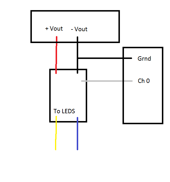

Re: Stuggling with the LDD Drivers
I'm thinking it is something in your wiring or your driver.
Can you post a sketch of how you connected stuff together?
If you disconnect the white ch0 wire, what voltage do you get on channel 0?

I just checked it and I am getting zero volts out of each channel ( 0 - 5 ). To make sure my voltmeter was working, I then checked the ATO ports where I got 4.75 volts. So what am I doing wrong to only get zero volts?
