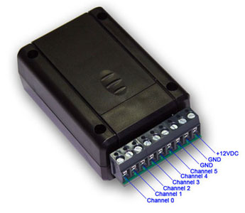

Re: PWM Expansion
Here is the pinout:
BigWave

Quick question regarding the voltage on the PWM expansion.
Using a Voltmeter, if I connect the 12V to a ground, I should read 12 Volts DC, correct? Or is that an input of 12 V?
I ask because I am getting nothing across the pins of the PWM expansion currently. I did put the two jumpers inside the main head unit, and the USB cable is connecting the expansion to the relay box. I do have a green led lit up inside the expansion.
If it matters, here is my code, just in case I am messing up the expansion somehow.

Re: PWM Expansion
On the pin out diagram above, +12VDC and GND on the right most header is actually input and not output.
You need to feed 12VDC with a power supply to source power to the booster circuit.
With your code, what Curt was saying is to use your code like this:

Re: PWM Expansion
Connecting the fan directly to the PWM expansion module is not recommended.
It will create unwanted spikes and feedback voltages on the module, unless you place a diode to take care of this unwanted side-effects.
But, even if you do that, you will still incur in humming noise being generated by the PWM frequency being applied directly onto a DC motor.
I'm using 120mm PWM controlled fans on my system just fine when connected directly to the PWM module, but I did have problems when I started using these high power PWM controlled blowers. They were generating too much noise in the system and it was causing it to lock-up. The solution was to create an opto-isolation board to isolate the blowers from the module and it's been working beautifuly for severals months now.
Re: PWM Expansion
Just a quick note I forgot, my 120mm fan shares the same 12V wall wart as the PWM Expansion module, so all you need is 3 wires from the module directly to the fan.
12VDC
GND
Channel 5 PWM output
12VDC
GND

GROUND DOUBT
When you say to use a power supply 12V in PWM Expansion OK, but the ground should be the (-) from the same 12V power supply?
12 V Power Supply =
+12V -Ground?
12 V Power Supply =
+12V -Ground?
