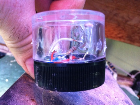

Hi all,
Awhile ago I was working on a light sensor for the aquarium. http://forum.reefangel.com/viewtopic.ph ... =cds#p4008 I finally got around to setting it up last weekend. I thought I'd share it with you all. I like that I can actually confirm the lights are on and maybe I'll be able to pick up a loss of lamp intenstiy over time. The pieces are really cheap. You just need to connect to the analog pins of an IO module or use a your own Arduino to connect to the RA.
Here is a picture of the meters I use. I just found these little containers at an art store and used a little silicone to seal the cable in and hold the photoresistor in place.
I used this code on my I/O module to smooth the signal and scale it to a single byte.

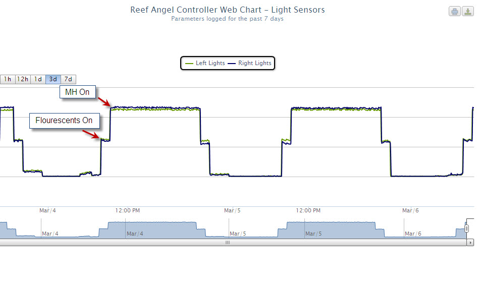

It seems to work well and I can see the fluorescents and the MH turn on and off as schedule. The graph of the light sensors on as custom variables looks like this....
light sensors.jpg (78.16 KiB) Viewed 9993 times
Let me know if anyone wants more info or if some of you more expreienced programmers could clean up my amateur code. ;)

A couple of things to consider...
1. I used a pull down resistor as in the desription here http://learn.adafruit.com/photocells/using-a-photocell.
2. I 'hacked' a wire to the analogue pins of the I/O chip. I think you could also get one modified like this if you want.
3. I wrote my own code to send the data over I2C communication and scale it to a single byte. I think you could use the default code as well, but I have lots of other stuff going on with my I/O so the code is pretty custom.
As always, I am not either a programmer or electrician so I'd defer to the experts here if they have a better way to do this. I'm happy to help if I can.
-Jon
