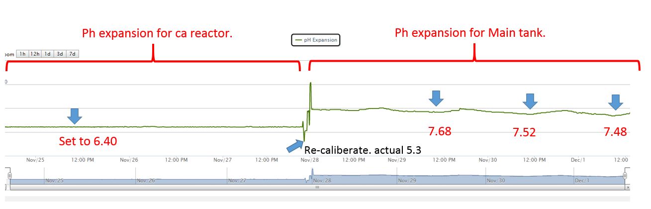

But why my ph expansion going down every day
Saturday 7.6. Sunday 7.5. Monday 7.4. I just swap ph expansion to my main last Saturday. (used to connect CA reactor, but saw same problem.)
It's not possible for my main tank down to 7.4, used to be 7.7 or high in mid of day (connected and measured by head PH, very stable). code patch does nothing with this defect. any clue about this?

the pic shows problem happens in my ph expansion measurement. need help :cry:
Re: ph expansion and ph control issue.
Do you get different readings if you put the probe in a cup of tank water? Its either stray voltage or bad probe.

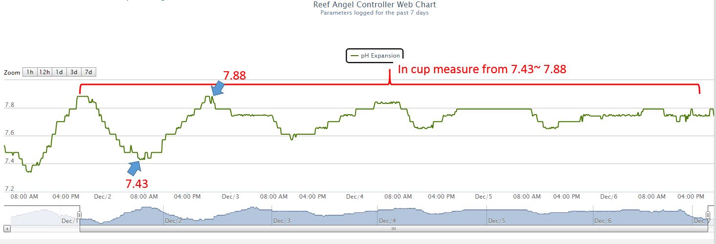

lnevo wrote:Do you get different readings if you put the probe in a cup of tank water? Its either stray voltage or bad probe.
just put probe in cup for a week. see pic below.
its ups and downs from 7.43~7.88. how this happens and what cause that?
The cup of tank water is just temporary to see if there is any interference with stray voltage, which seems that is not the case.
It looks like it is working right when it is in the tank.

Post by sesame »
rimai wrote:The cup of tank water is just temporary to see if there is any interference with stray voltage, which seems that is not the case.
How its ups and downs even in cup measurement. Is this in measure tolerance range?
That may have been temperature variances.
