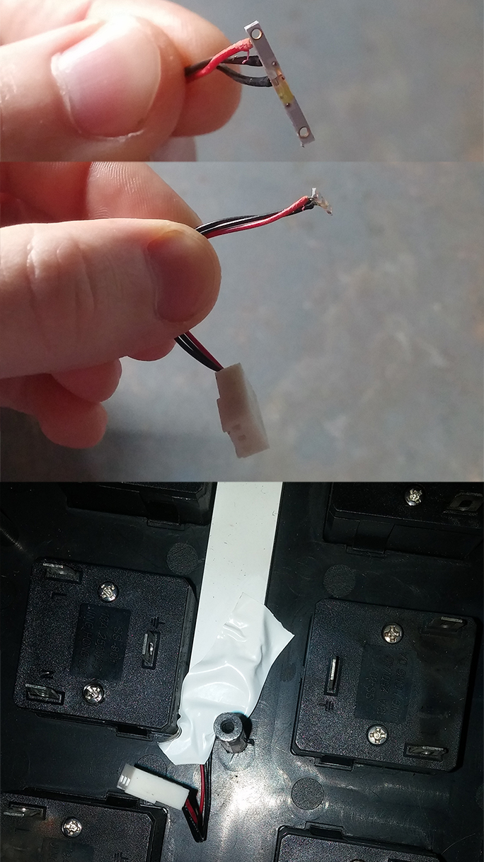

I did it and when I opened the relay module the wire that is connected to the RANet module was not connected to anything.
I could not see where it should be connected.
I put the whole thing back together and it all seems to be working in terms of the ports all turn on and off remotely, but the Reef Angle logo doe not light up at all now.
It worked fine before.

Sacohen wrote:Thanks for the update.
The logo plugs into that connector
Re: RANet firmware update
I'll open it again, but the other end coming from that connection was not attached to anything.
Sent from my SM-G928P using Tapatalk

Sacohen wrote:I'll open it again, but the other end coming from that connection was not attached to anything.
It's a very tiny LED. I thought the same thing. It's supposed to be glued/taped to the closest end of the RA logo to that connector. I used electrical tape.
Thanks. I thought it was something like that.
