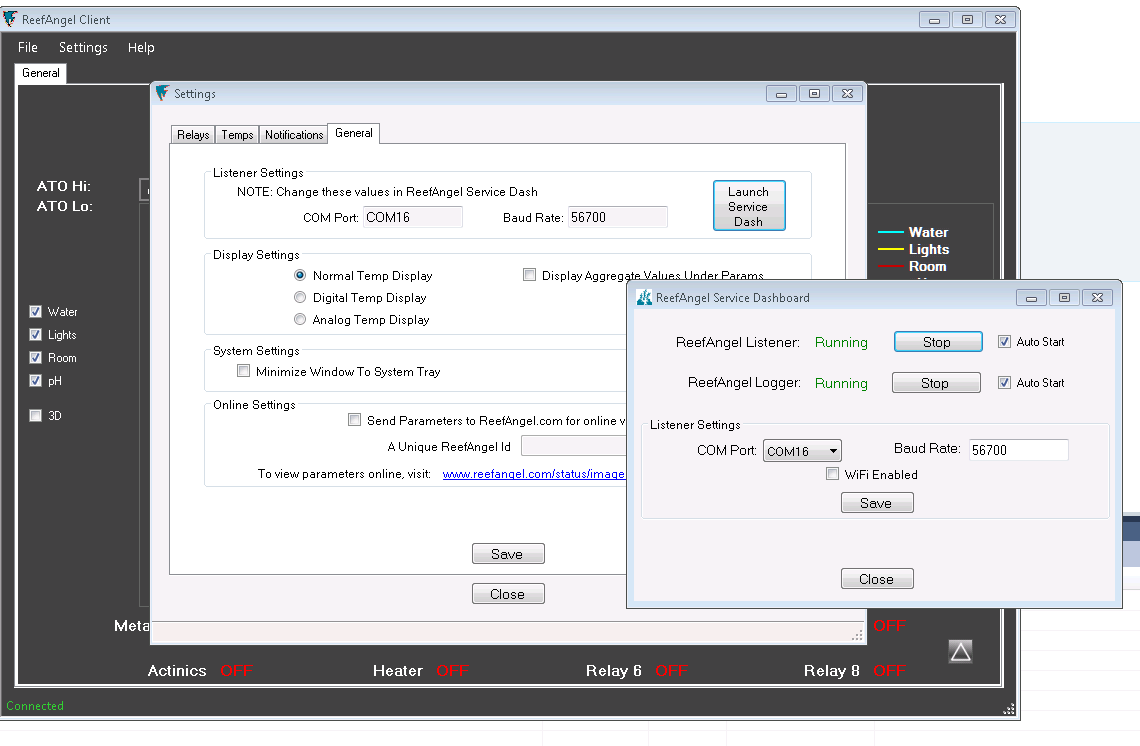

Hi Roberto:

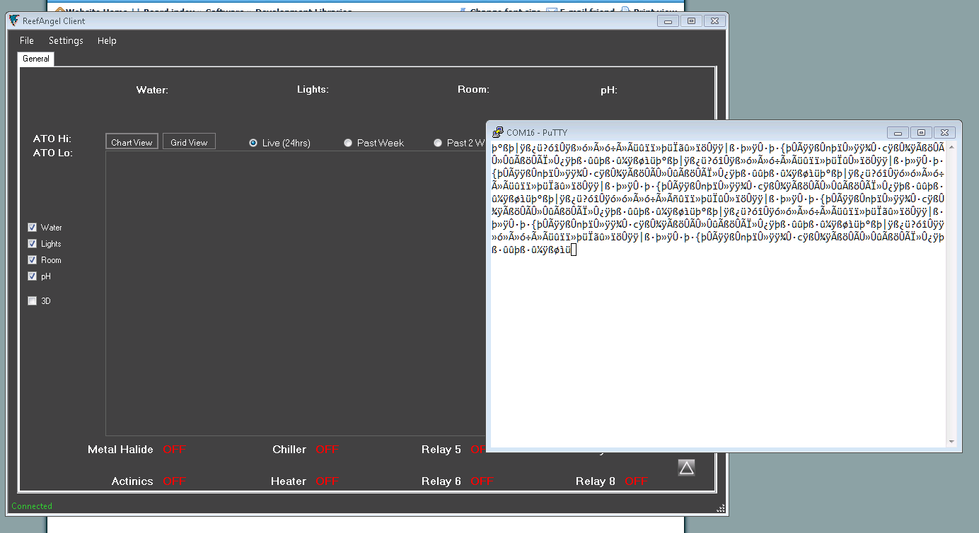

When you refer to configure serial, do you mean from ReefClient Service Dashboard Wifi NOT selected. I have Port 16 open at 56700, as well as "Listener" and "Logger" service running.. As you can see from thr pic I can open up Putty at anytime on Port 16 56700,8,N,1, and some data comes through every minute or so. Seems the listener is not "listening" otherwise the port would not be available for Putty?

What do you have on "COM Port" under menu "Settings->Modify" and tab "General"?

Re: PC Logging
Com 16...

No go, I have changed around with it so many times I must have typed it in wrong on the last go, changed to 57600, but still not working. Still can't explain why putty will open up when reef Client is open, the port should be locked. Strange. Wonder if it is my max232 setup is part of the problem. Think I best try a pic USART project to see if it can communicate correctly with putty at 57600. Perhaps the data is garbled and the controller doesn't recognize the sequence.

If the Listener cannot open the serial port COM16 on 57600 right away, an internal timer will start for 30 seconds and then it will try again. It will repeat that process until it can lock the serial port and begin communicating.
In addition to that, when you make core changes to the listener settings, it will restart the service in order to actually apply them. It takes a bit to do that and you should probably see some red text at the bottom status bar of the Client saying "Unable to connect. Retrying in 2:00". After two minutes the Client will reconnect and begin displaying data.

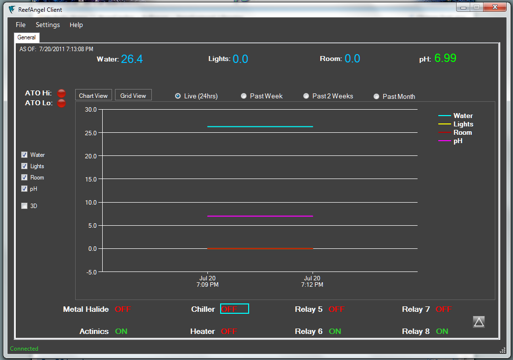

Success!!!.
Problem was twofold. I was getting the red text at the bottom, but while the listener was waiting to connect and turn green I would open Putty. This obviously locked the port for Reef Client so it could not receive anything from the listener. The garbage data on Putty was due to a cap on the MAX232 circuit not being fully seated. The SerialReader app worked like a charm, very helpful.
Picture speaks a thousand words. Thanks everyone, much appreciated.
