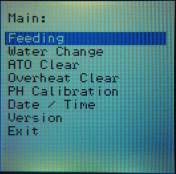

I got the simple menu working today. It still needs to be tested more with all the features but I'm pretty sure it's gonna work just fine. I have pushed my changes to my github account. Please make sure you read the ReefAngel_Features.h file and the comments at the bottom of the file on how to use the feature. It also explains what features will work with the simple menu and what will be ignored.
Here's what the menu looks like:
I'm still working on the ability to have a custom menu.
Lastly, the important part that everybody will love to hear. Using this menu will actually save you about 4566 bytes. Yes, that's about 4,500 bytes of extra memory available for other stuff. That's the value that I got from using my RAMenus PDE file with the default features enabled and the default functions. The only thing I did different was enable SIMPLE_MENU and I noticed the 4566 bytes difference.
Anyways, feel free to grab the latest and test it out if you like.

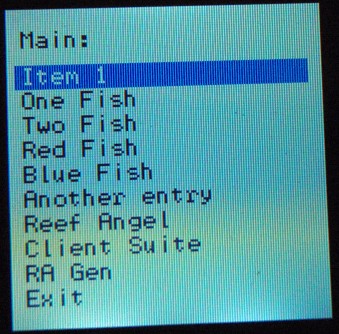

Well, I must say that I have a preliminary working (yes, I did say working) version of the custom menu. It can be defined and all contained within the PDE file. You can create your own menu entries and have it perform all the tasks that you want. This will open up all sorts of possibilities and possibly some confusion as well with the menu events but that's just how it goes when you want lots of customizing opportunities.
Some stuff will have to be repeated unless I create custom functions for them (like displaying a setup menu and stuff like that). I haven't created those functions because they increase code size. However, at the expense of increasing the code size a little for simplicity of the menus I think it would be manageable.
In this working example I have so far, you cannot display any of the setup screens. I'm thinking that some people would want to have access to some specific setup screens, like maybe an ATO or Lights or something. Although this is not necessary now that we have the memory page on the Client Suite and also my Status application.
Another limitation is that you an only have 1 menu screen with a max of 9 entries. This should be more than adequate for everybody.
Anyways, here's a sample screenshot that I created of all 9 entries in use. I still have more testing to make sure things work as expected. If anybody would like to help me test out, keep an eye on my github account for the "custom_menu" branch.
Feedback (comments and suggestions) are always welcomed.
