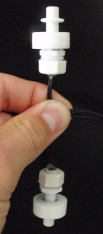

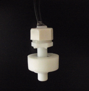

Inside the ATO class in the code, there is a function that is called IsActive.
IsActive - Means the float is not touching the end with both wires coming out of it. So when the code says "ato->IsActive()" that means that the float is not touching the end with the wires. See the picture for a visual.
