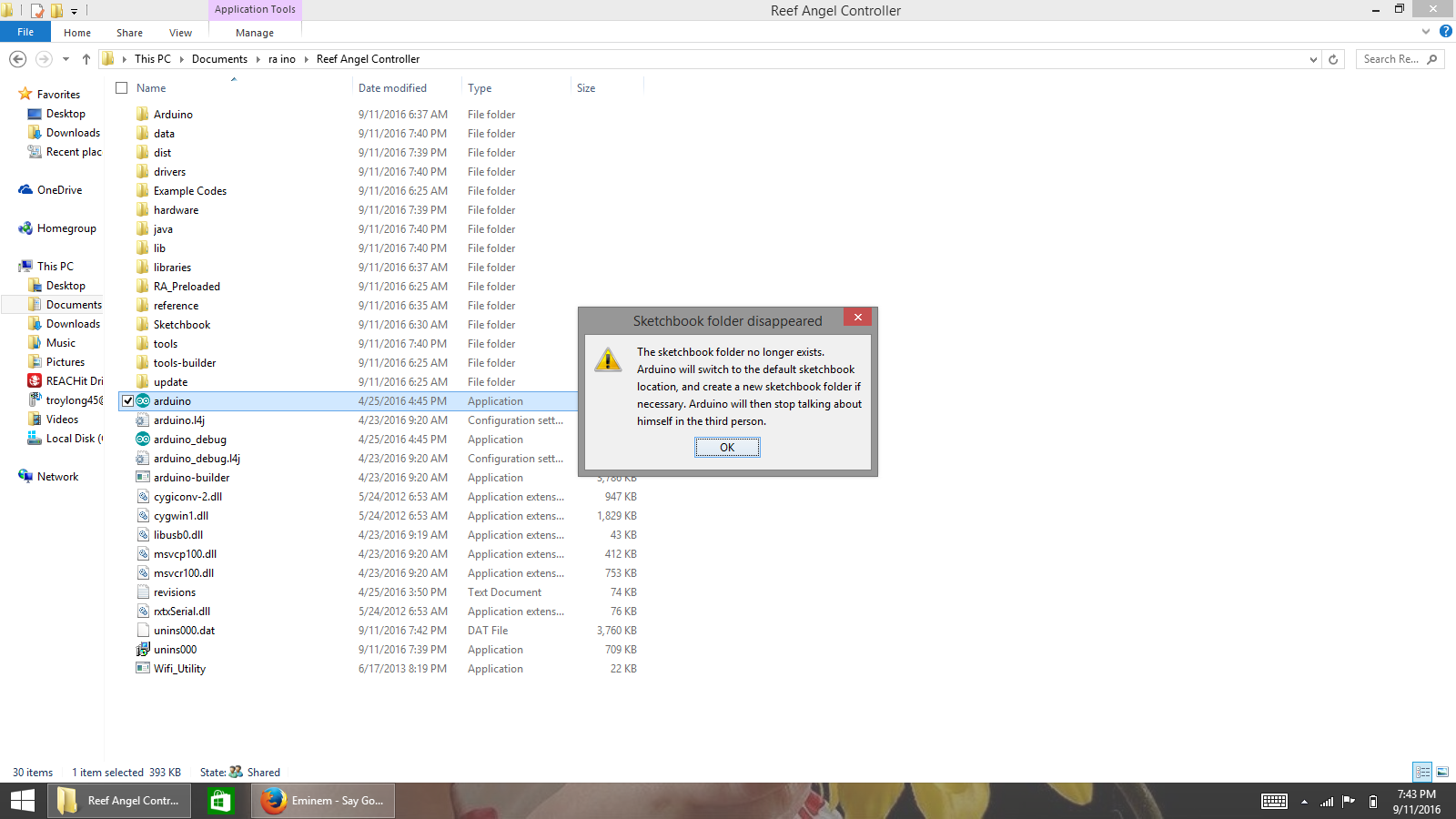

On Windows Im getting sketchbook folder disappeared and wont open
Re: New IDE v1.6.8
Does open at all?
Can you post screenshot of this error?

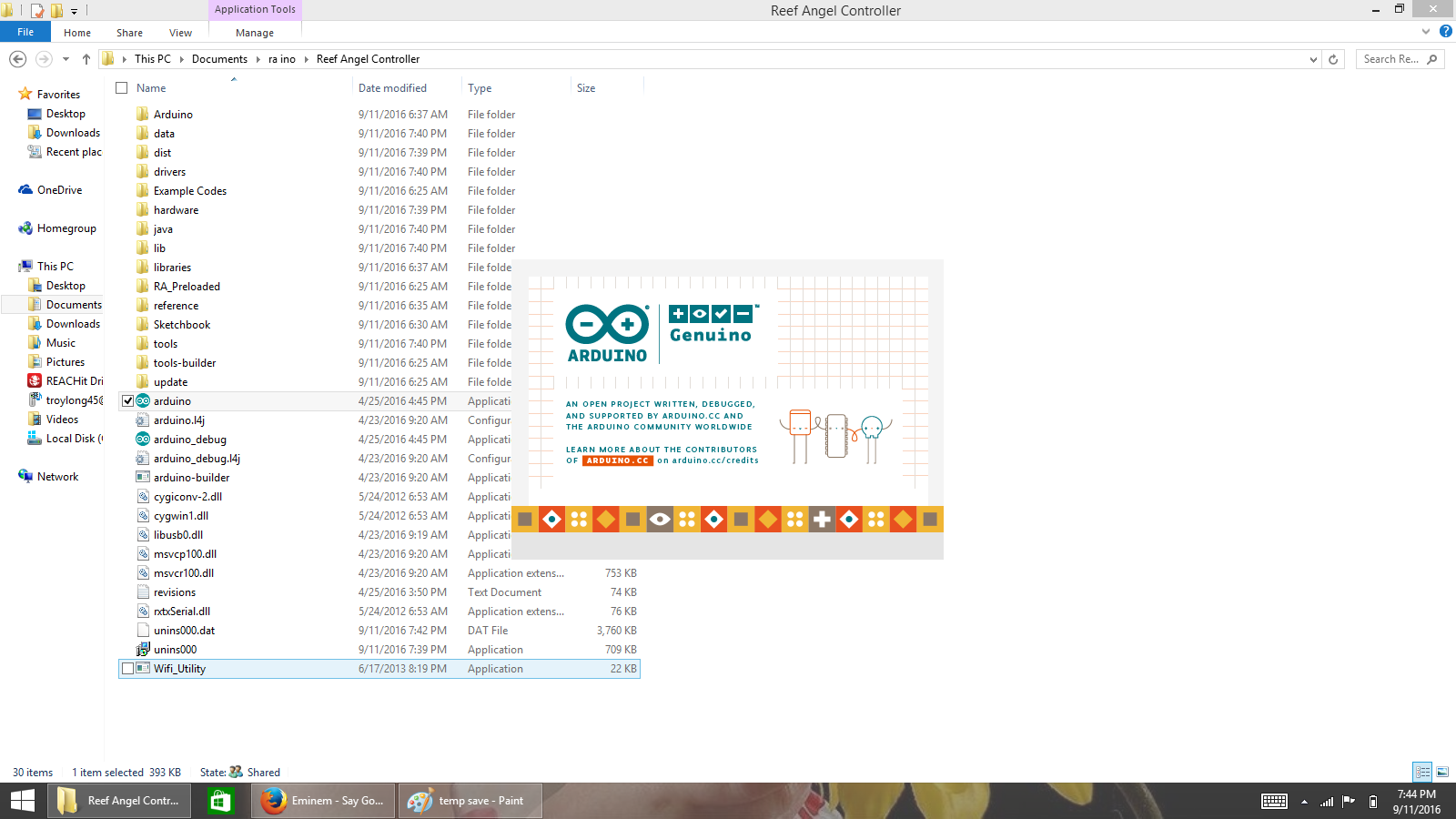

Not past the initial boot up screen . Ill try to put up a screen shot later tonight or tomorrow
troylong45
Posts: 203
Joined: Sat Oct 10, 2015 9:17 pm
Re: New IDE v1.6.8
Post by troylong45 »
temp save.png (164.85 KiB) Viewed 17172 times
Re: New IDE v1.6.8
You should not install the Arduino IDE inside the sketchbook folder.
I would recommend it installing it in the default folder it recommended during the install.
If you do want to keep it installed in that location, make sure that you update the sketchbook folder in the preferences file manually since you can't access the IDE.
The preferences file is located at C:\Users\your_name_here\AppData\Local\Arduino15
