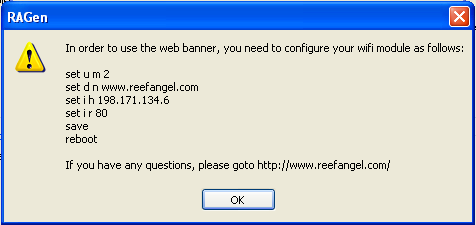

Do you have your wifi module configured to send the data to reefangel.com? If not, the data will not get sent.
Read up on this page: http://www.reefangel.com/Enable-a-Web-B ... controller
Here is the screenshot of the window that contains the settings. These instructions should also be in the manual as well.
Web Banner wifi settings
If you do this, then you should be working.
