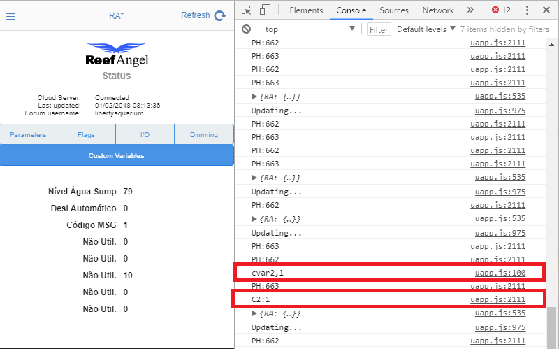

May be nothing, but publishing the message "c2:1" to username/in does not take any effect.
In fact, looking the messages using google chrome console log, when we try to change any variable it's sending the command "cvar2,1", and than the "out" channel responds with "C2:1" properly.
Re: RA* Cloud - mqtt publish commands
Posted: Thu Feb 01, 2018 10:13 am
There ya go. :)
