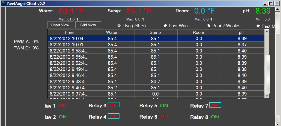

I put the probes side by side into the tank and these are the readings.

OK, it gets better. I removed these probes and put them on my desk. They indicate 78 and 79 F (the room temp is 81), I think I can live with that error. I guess I may have some electric current leak in the tank. Would this interfere with the probe reading? I will check it tomorrow turning off all the appliances one by one. Does it make sense?
