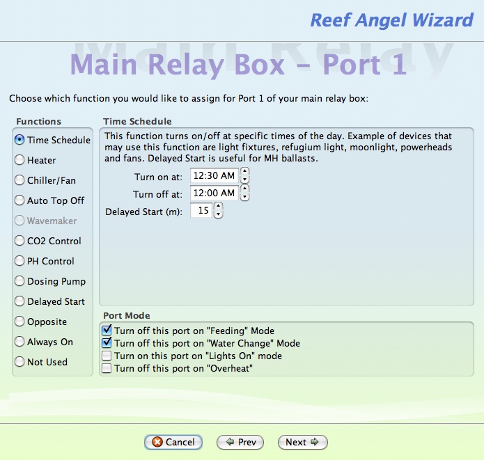

I'm pretty sure. Here's a screen shot of my Port 1 on Relay 1. Am I doing something wrong?

That time delay is for halide ballasts as mentioned on the description. It only works on power up.
If you want for feeding/water change mode, you must use the Delayed option.

I have programmed dosing pumps to put in about 10mL of plankton at midnight. I would like the skimmer to stop functioning from 0000-0030 so that the plankton gets to circulate prior to being skimmed. Thus the rest period. Since I'm not manually feeding the tank it was never placed in a feeding mode. Makes sense?
Re: Delay doesn't appear to be working
Oh, that's what I was getting confused.
You don't want the delayed on function at all then.
Why don't you just place the skimmer as time schedule to turn on at 0:30 and turn off at 0:00??

I originally did that but I was running into problems after running the feed mode when the water will rise in the sump. When the system restarts after feed mode lapses, the skimmer would not have a delay and then overflow. I kind of need a hybrid of delay mode and timer mode.
Ahhh.
You need a custom code then.
Setup the port as delayed on, then use this custom code too:
if (hour()==0 and minute()<30) ReefAngel.Relay.Off(Port1);
