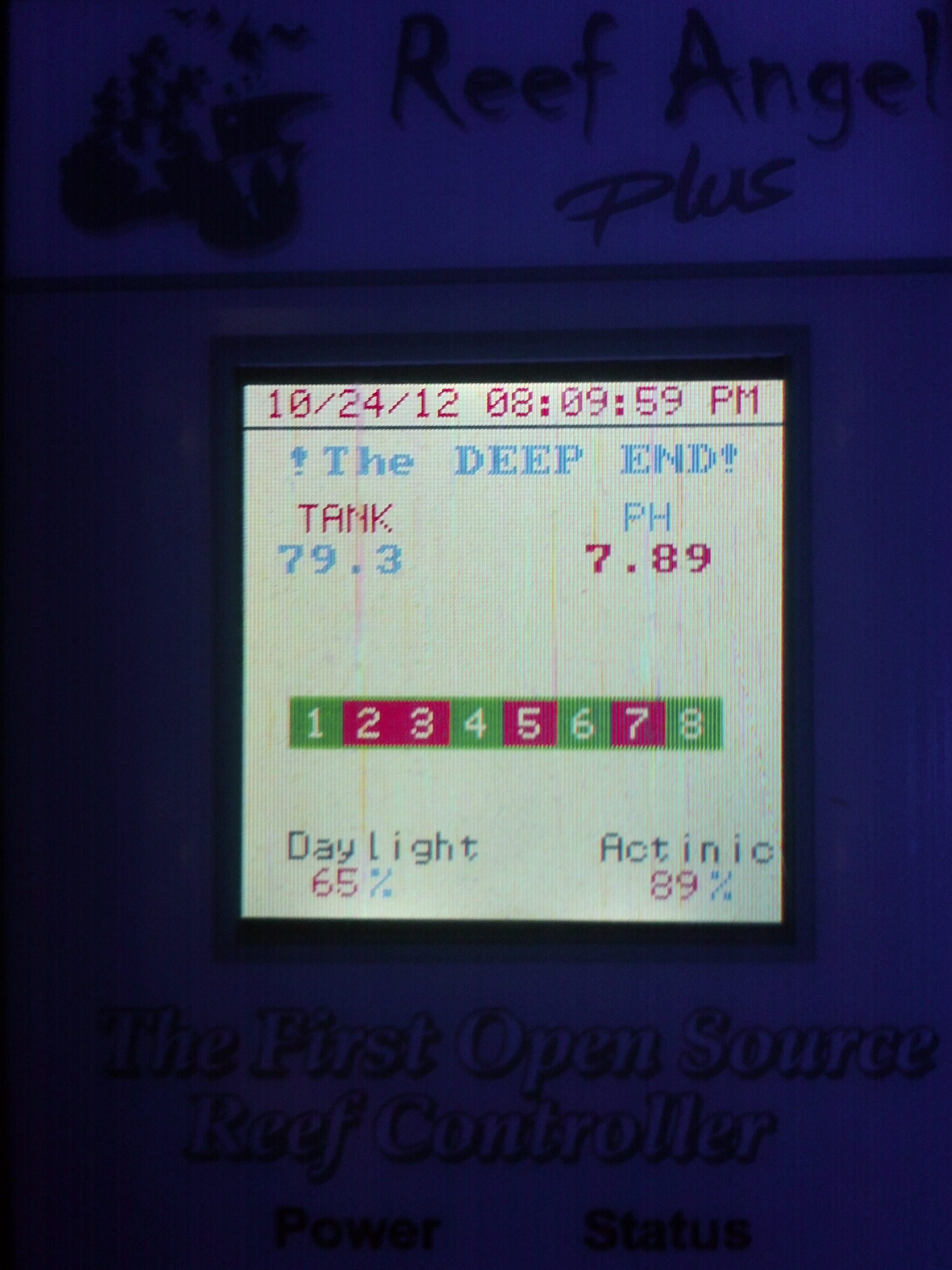

thank you casper for the hook up and custom screen and menus!!
