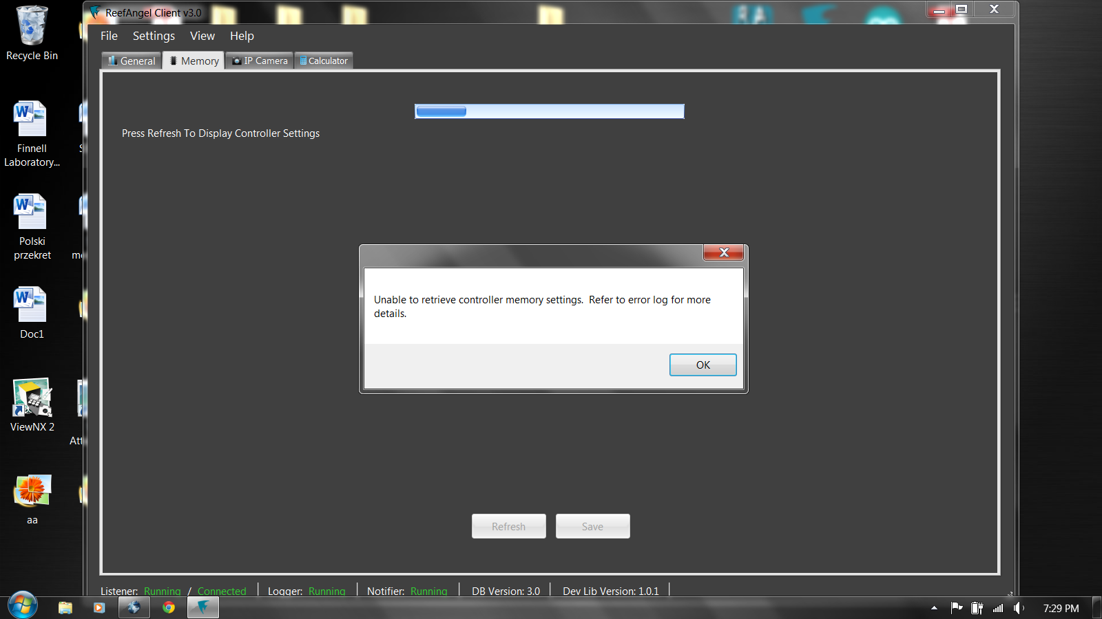

Re: portal problems?
Loaded the new RAMmemory and it says new memory file successfully verified and loaded.
Then when I click Memory on client and refresh I got this"
- Untitled3.png (249.51 KiB) Viewed 7464 times

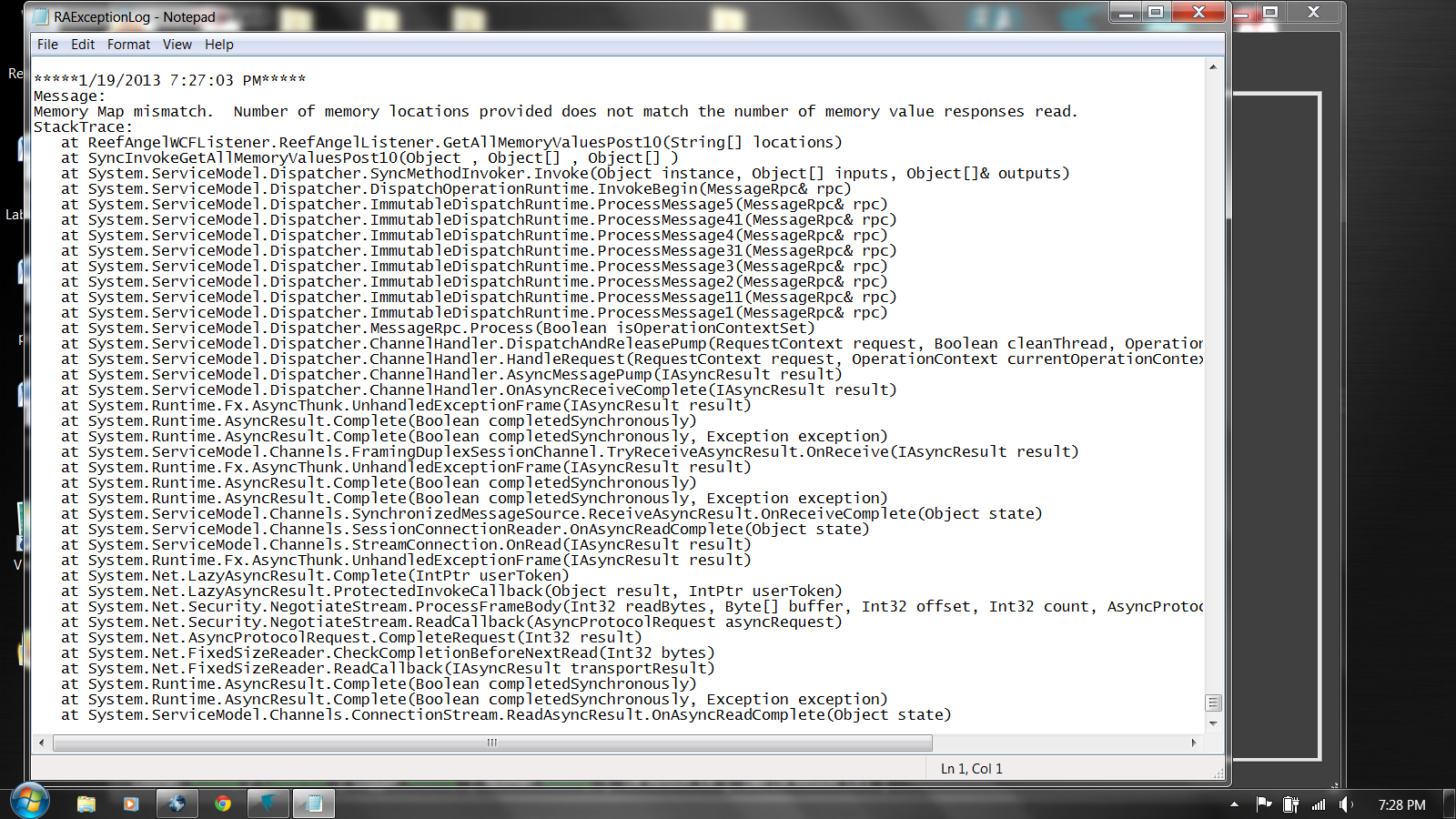

And then in log error I see this:
- Untitled2.png (307.84 KiB) Viewed 7981 times
I closed and restarted, no help. Then rebooted the comp, no help.
Now the general settings on Client work but can't refresh memory or access it at all.
I see what the issue is. It will require a software patch. Working on it now.
Okay, sorry for the issues you experienced with the Client. To keep things simple, I created a new installer that includes the changes that should fix parameter syncing to the portal over USB. From the control panel, please first uninstall your current version of the Client Suite, download and install the new one located here: https://github.com/davemolton/Client-Su ... ta_301.zip
You fixed it, as you can see in the signature area, the banner shows data up to date.
However I still can't open my memory on Client, when I click refresh I get the the same message and error log file like above in this thread. Sorry to cause so much trouble.
