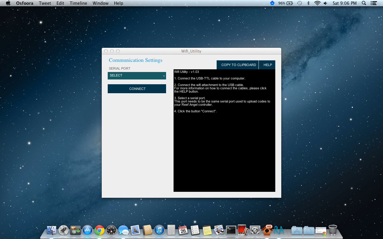

I have a Mac and the wifi utility that's in the folder that you download works great. I also use coolterm to connect to the wifi module for other settings.
Re: new to RA and connecting to Mac
Make sure you download the Reef Angel Installer from the website and follow the instructions in the manual on how to move the libraries folders to your Mac computer.
The wifi utility is also inside the same package.
You can move it to your applications folder and it will always be there for you.
Screen Shot 2013-01-26 at 9.06.11 PM.png (884.45 KiB) Viewed 8274 times
When you say wizard are you using the RA wifi utility?

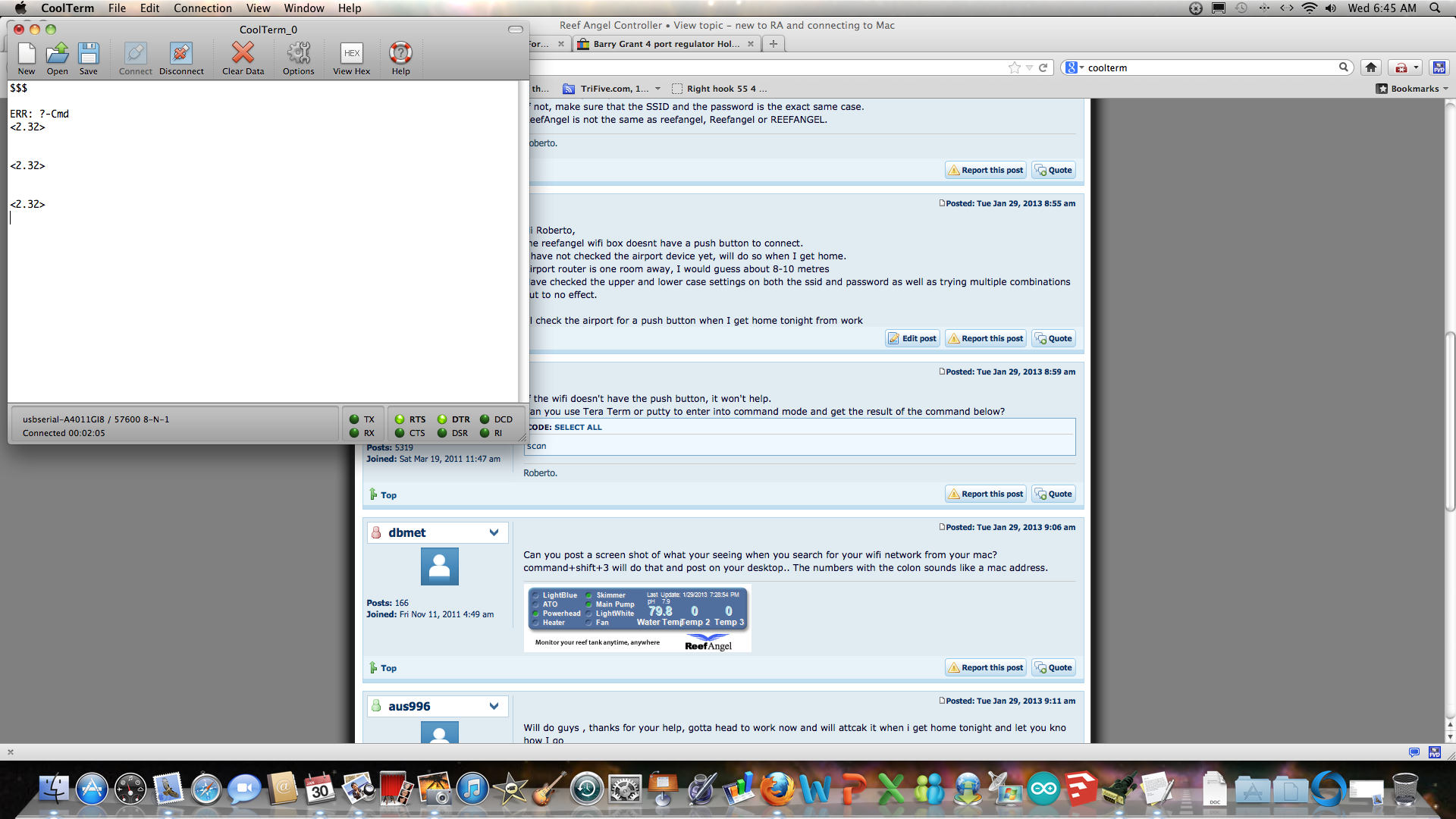

Ok guys getting there.
Have learnt how to take screen shots on a mac :mrgreen:
and upload picture on the forum :mrgreen:
uploaded coolterm as it was the only one that i could see that had an option for Mac os :mrgreen:
Now what?
I managed to get a string of $$$ sent and you can see the cool term screen shot, but really have no idea what I am doing or looking for here :?:
Ive still got to get a screen shot of the other errors, hopefully I will get some more time tonight to get to it, only had about 10 minutes before shooting off to work again
thanks for your continued support cheers
desk top shot
desk top shot
Screen shot 2013-01-30 at 6.45.00 AM.png (480.95 KiB) Viewed 7856 times
Awesome!!!
When you see the <2.32> you are ready to send commands to the module.
Try this command:
scan
You need to hit enter after the command.

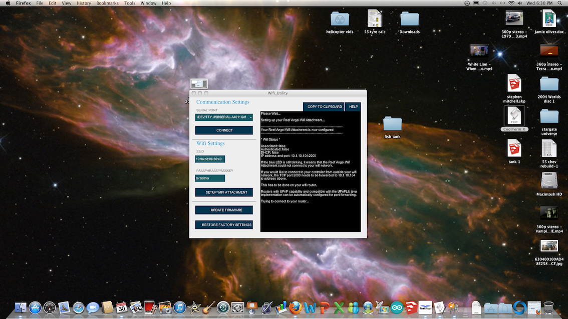

Hi Guys have a screen shot of the wifi wizard status now, still now joy on connecting. Hope the photo isnt too small tho
Screen shot 2013-01-30 at 6.30.44 PM 2.png (983.92 KiB) Viewed 7842 times

If the Prometheus is the ssid that your connected to on your laptop then that's what you need to put in the wifi wizard in the spot that says ssid. You have a MAC address in that spot now. You can look at the wifi signal indicator on your Mac in the top right corner to make sure that's the name of your ssid.
Also, I think WPA2PSK-TKIP encryption is not supported by the manufacturer.
Try changing it to WPA2PSK-AES encryption.
aus996
Posts: 40
Joined: Wed Dec 19, 2012 12:02 am
Post by aus996 »
thanks roberto, its likely to be the encryption thing, ill check how to change this and give it a shot cheers steve

AND TODAY'S I.T. AWARD GOES TO......... :?:
Me :!:
For putting in the code string for the ssid instead of the name of the airport which had been staring at me all the time. Of course once that was plugged in it worked first time. Also note that when you are in the wizard (for mac anyways) you can't hit 'all caps' as the text box recognizes this as a keyed input (little faded square) and screws up your ssid.
of course IT savvy people would know this, but for the rest of us mere mortals, well enough said.
