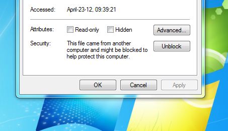

OK, lets look at the file properties. Right click on the file and see if you get this:-
Check at the bottom to see if you have the file Blocked for security protection. If so click to unblock.
That should work. :)

There is not an EXE file in the JAR file. The JAR file is a java executable file. What you need to do is simply download the JAR file then you double click on it to run it. If you have java enabled on your computer it should automatically launch and run the app. You may have to "unblock" it like Sebyte said, but otherwise it should simply run without any other extraction or unzipping.
