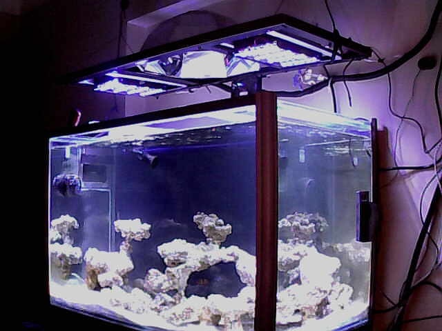

Here is my light system so u can imqgine what i am talking about
I have blue and white led and metal halide i need blue first then white then metal halide
when it comes to programming i "always need help "
