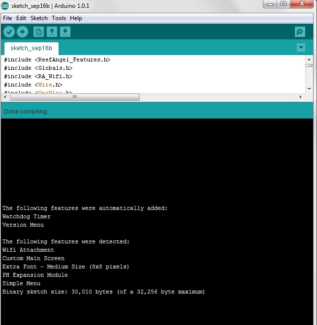

Any reason why you can see why the uplioad is giving me an error
Verification works but then when it finishes the upload it says "Error uploading" in an orange notification
ReefAngel.LCD.DrawDate(6, 64);
ReefAngel.LCD.DrawLargeText(COLOR_DARKTURQUOISE, COLOR_WHITE, 19, 4 , "BOBS REEF");
ReefAngel.LCD.Clear(COLOR_MAROON, 1, 13, 132, 13);
ReefAngel.LCD.Clear(COLOR_MAROON, 10, 75, 119, 75);
ReefAngel.LCD.Clear(COLOR_MAROON, 10, 59, 119, 59);
ReefAngel.LCD.DrawLargeText(COLOR_GOLDENROD, COLOR_WHITE, 33, 15, "Tank Water");
char text[7];
ReefAngel.LCD.DrawLargeText(COLOR_GOLDENROD, DefaultBGColor, 15, 26, text);
ConvertNumToString(text, ReefAngel.Params.Temp[T2_PROBE], 10);
ReefAngel.LCD.DrawLargeText(COLOR_GOLDENROD, DefaultBGColor, 60, 26, text);
ReefAngel.LCD.DrawLargeText(COLOR_MEDIUMSEAGREEN, COLOR_WHITE, 15, 35, "pH");
ReefAngel.LCD.DrawLargeText(PHColor, DefaultBGColor, 15, 42, text);
ReefAngel.LCD.DrawLargeText(COLOR_MEDIUMSEAGREEN, COLOR_WHITE, 60, 35, "pH2");
ConvertNumToString(text, ReefAngel.Params.PHExp, 100);
ReefAngel.LCD.DrawLargeText(PHColor, DefaultBGColor, 60, 42, text);
ReefAngel.LCD.DrawText(COLOR_MEDIUMSEAGREEN,DefaultBGColor,10,84,"ATO");
ReefAngel.LCD.DrawText(COLOR_MEDIUMSEAGREEN,DefaultBGColor,10,94,"N/A");
ReefAngel.LCD.DrawText(COLOR_MEDIUMSEAGREEN,DefaultBGColor,10,104,"CO2");
ReefAngel.LCD.DrawText(COLOR_MEDIUMSEAGREEN,DefaultBGColor,10,114,"N/A");
ReefAngel.LCD.DrawText(COLOR_MEDIUMSEAGREEN,DefaultBGColor,80,84,"Return");
ReefAngel.LCD.DrawText(COLOR_MEDIUMSEAGREEN,DefaultBGColor,80,94,"Vortech");
ReefAngel.LCD.DrawText(COLOR_MEDIUMSEAGREEN,DefaultBGColor,80,104,"N/A");
ReefAngel.LCD.DrawText(COLOR_MEDIUMSEAGREEN,DefaultBGColor,80,114,"Heater");
ReefAngel.LCD.DrawCircleOutletBox(60, 86, TempRelay, true);
    ReefAngel.SetTemperatureUnit( Celsius );  // set to Celsius Temperature
    InternalMemory.OverheatTemp_write( 260 );
    ReefAngel.SingleATO( true,Port2,60,0 );
    ReefAngel.StandardLights( Port3,4,0,23,0 );
    ReefAngel.StandardHeater( Port7,250,255 );
    if (ReefAngel.Params.PHExp <= 635) ReefAngel.Relay.Off(Port6);  // If probe 2 PH <= 7.35 - turn off CO2
    if (ReefAngel.Params.PHExp >= 652) ReefAngel.Relay.On(Port6);  // If probe 2 PH >= 7.52 - turn on CO2    if (ReefAngel.Params.PH <= 790) Relay.Off(Port6);  // If PH <= LowPH - turn off CO2
    if (ReefAngel.Params.PH <= 790) ReefAngel.Relay.Off(Port6);  // If probe 1 PH <= 7.90 - turn off CO2
    ReefAngel.Portal( "Lockes" );
Watchdog Timer
Version Menu
Wifi Attachment
Custom Main Screen
Extra Font - Medium Size (8x8 pixels)
PH Expansion Module
Simple Menu
Binary sketch size: 30,010 bytes (of a 32,256 byte maximum)

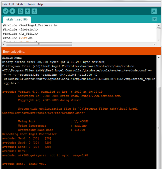

C:\Program Files (x86)\Reef Angel Controller\hardware/tools/avr/bin/avrdude -CC:\Program Files (x86)\Reef Angel Controller\hardware/tools/avr/etc/avrdude.conf -v -v -v -v -patmega328p -carduino -P\\.\COM6 -b115200 -D -Uflash:w:C:\Users\Andrew\AppData\Local\Temp\build6963156121354196331.tmp\sketch_sep16b.cpp.hex:i
avrdude: Version 6.0, compiled on Apr  6 2012 at 19:29:19
         System wide configuration file is "C:\Program Files (x86)\Reef Angel Controller\hardware/tools/avr/etc/avrdude.conf"
         Using Port                    : \\.\COM6
         Using Programmer              : arduino
         Overriding Baud Rate          : 115200
avrdude: Send: 0 [30]   [20]
avrdude: Recv:
avrdude: stk500_getsync(): not in sync: resp=0x64
avrdude done.  Thank you.
Error Uploading

Verify works fine
between the code and the upload message below is the error in orange saying "error uploading"
I will try load a screenshot as well if needed

Check
Reef Angel Controller w/ optiboot selected - YES
Only allows me COM6
Compiled correctly as per blow
Error as per below
error uploading.png (147.02 KiB) Viewed 6349 times

i am having the exact same issue i uploaded my original code when i received my reef angel using the wizard. It worked fine and i also have the wifi and salinity expansion. but ever since then i haven't been able to load any new code, i always get the same message and have tried all the normal solutions with no help.
Re: Error Uploading
Does it reboot a few seconds after you hit upload button?
Which RA do you have?
Can you post your error code shown in the screen?
DanJ70
Posts: 4
Joined: Mon Jan 07, 2013 2:38 pm
Re: Error Uploading
Post by DanJ70 »
Yes i think it does, everything turns on. which brings me to another question if i dont want a port to turn on everytime it resets, should i label port not used instead of always on. I'm a newbie but i love my reef angel and travel alot id really like to get full usage of my reef angels potential. Im a big fan thank you for your help. here's the message i got after trying to upload.
Watchdog Timer
Version Menu
Dimming Signal
Salinity Expansion Module
Wifi Attachment
Custom Main Screen
Simple Menu
Binary sketch size: 28,194 bytes (of a 32,256 byte maximum)
C:\Program Files (x86)\Reef Angel Controller\hardware/tools/avr/bin/avrdude -CC:\Program Files (x86)\Reef Angel Controller\hardware/tools/avr/etc/avrdude.conf -v -v -v -v -patmega328p -carduino -P\\.\COM4 -b115200 -D -Uflash:w:C:\Users\DANIEL~1\AppData\Local\Temp\build4719814583279372175.tmp\sketch_mar16a.cpp.hex:i
Copyright (c) 2000-2005 Brian Dean, /
Using Port : \\.\COM4
avrdude: Recv:
Re: Error Uploading
Do you have RA or RA+?
Is there any other serial port listed under Tools->Serial Port?
DanJ70
Posts: 4
Re: Error Uploading
Post by DanJ70 »
I just recently purchased my reef angel and downloaded the programs so im assuming its the plus, i did get the upgraded memory and i do have a serial port 3 but been using port 4
Re: Error Uploading
Ok, change the board to Reef Angel Plus under Tools->Board
DanJ70
Posts: 4
Re: Error Uploading
Post by DanJ70 »
ok Thank you i think that worked, i used the wizard and forgot to change that. I was wondering since i use my wifi and android app should i be installing the code on the internal memory.
