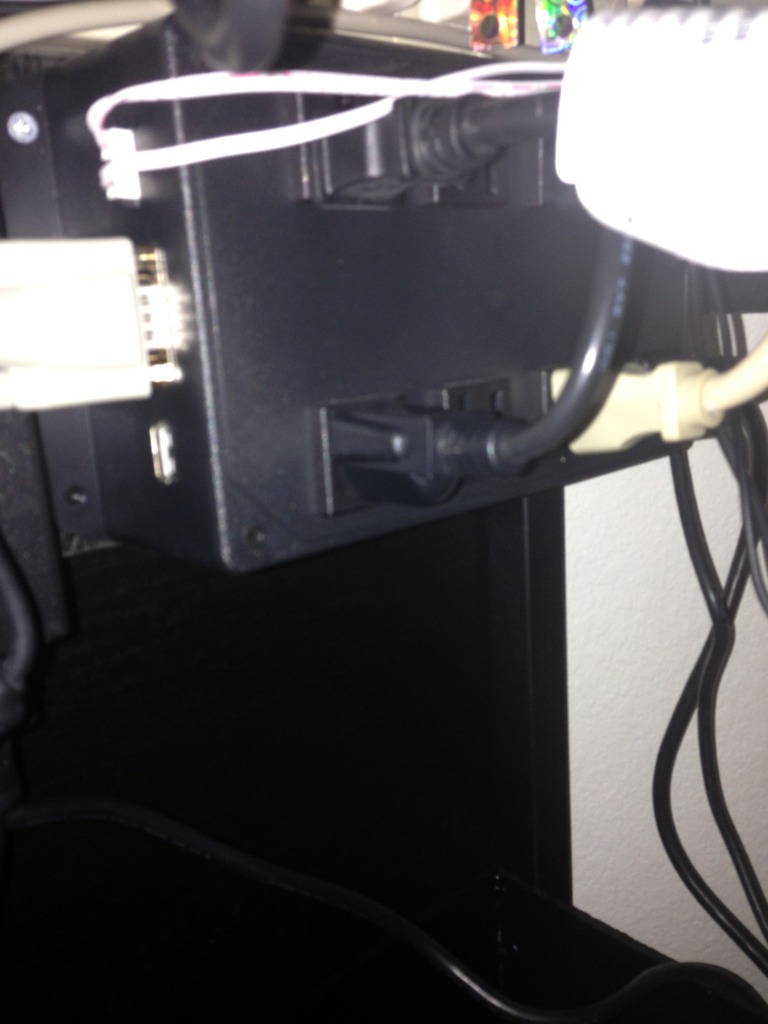

Are you sure it's plugged into the heater port? Can you send us a photo?

Yes it's plugged into heater port and no I do not get a red light. When I upload the RA reboots and everything. I am using optiboot as I did buy the RA controller with analog dimming signal 239$
Ill post a picture tonight of the controller screen it shows the heater outlet red. Right now it's on Heater is the bottom corner. My heater also has an external controller but its set at 90 degrees so it won't shut off.

Nvmnd I just realized the issue. According to manufacture of the heater if heater is on longer than 6 hrs at one time it auto shuts off. Stupid heater ill be replacing it. Now back to the error issue.
