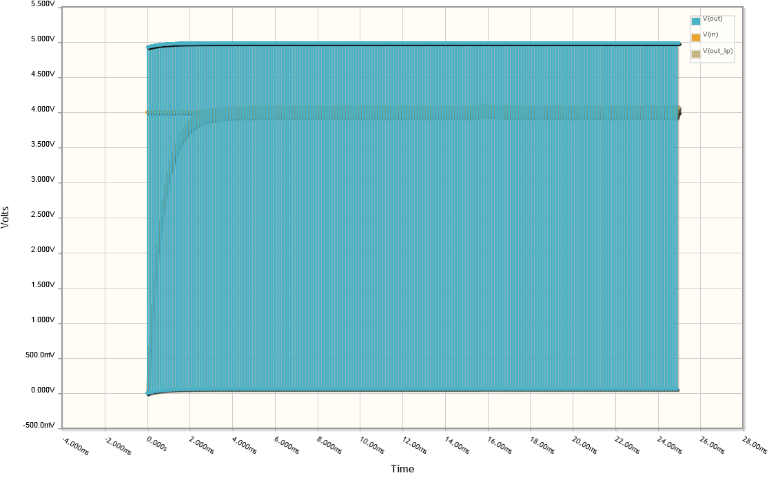

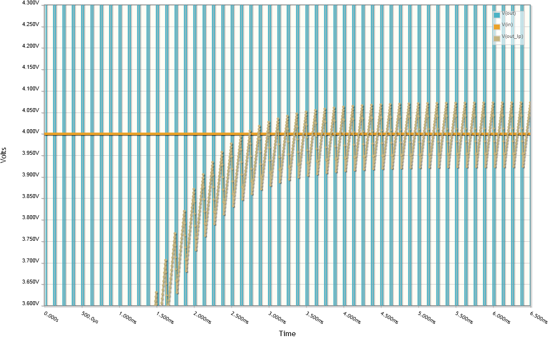

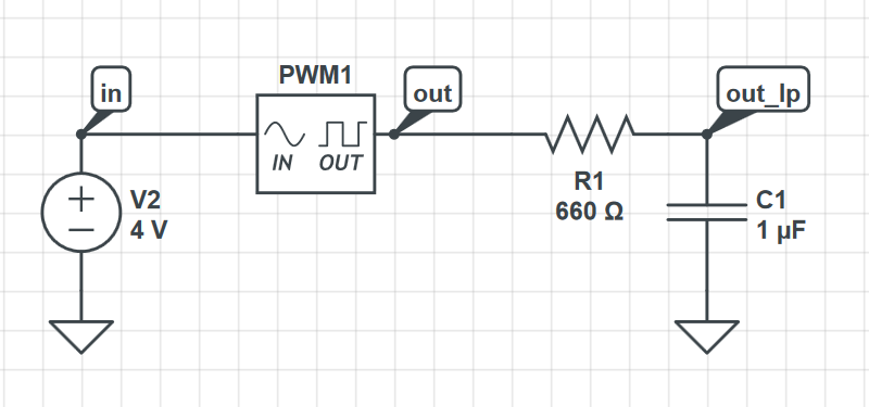

This is what I mean. Here is a time domain simulation from an LPF signal providing a steady 4V. I am of the understanding that since we are supplying a PWM signal to the LPF, you still have a frequency. The LPF smooths out the PWM signal but you can clearly see a ripple exists after the LPF. Thoughts?

Yeah.
The Jebao controller had horrible ripple :(
Too low capacitor for the small resistor they were using.
I think they were using 1K and 2.2uF.
I did not scope the frequency of the PWM signal from their controller because we really don't care what it is. Except to kill curiosity, like yours... lol
Even with the horrible ripple of the resulting analog signal, it doesn't matter to what we are using it for.
The pump is very high inductive in nature and transfer from the coil to the propeller is not instant. We have mass and several other factors to consider, which makes the ripple effect very negligible. The ripple can't go past the electromagnetic coupling, so who cares as long as it is low enough. I think that was their logic when they built their controller. The advantage of such low values of the lpf, you get very fast response on the resulting analog signal.
But, I don't think the electromagnetic coupling can respond to extremely fast response neither.
So, it really doesn't matter whether ripple is there or not and whether extremely fast response is there or not, the pump will always respond the same within a certain extent with whatever signal you apply, due to kinetic energy and electromagnetic transfer.
So, if your worry is ripple, I wouldn't worry much.
FWIW, my lpf is 10K and 10uF.

Thanks for the reply Roberto. My motor control guys agree. I ran your LPF values through a simulation and it looks good.
