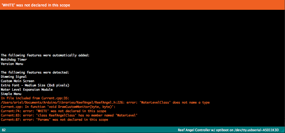

im trying to use the custom screen that showed here but when I upload the code, still showing the graph of the standard screen. Where in the code i remove that graph?
Re: Custom Main Screens
Bo0sted_Rafi wrote:im trying to use the custom screen that showed here but when I upload the code, still showing the graph of the standard screen. Where in the code i remove that graph?
Add this to the very end of the code posted above:
Did that fix it?

I wrote that but give me an error when i tried to compile
Take that code out of loop() and put it under your #includes (after "Place global variable code below here").
Try this:

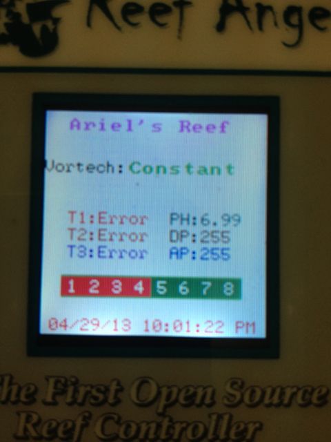

Im not the best at coding so i have chopped quite a bit from other people
Ideally i would love to take out the bottom two rows and have:
Tank Name
Vortech
2 LED Channels (got a vertex illumilux)
Temp
PH
Relays
ATO - Plan on getting one of the new ones - so if theres a way to see how full the reservoir is
if anyone is willing to help me, you would be awesome in my eyes :geek:
Oh, and no peripherals are connected right now as im in the process of switching tanks - incase youre wondering ;)

Thanks for pointing that out! So let me just make sure i understand, I should rather have all the vortech modes lined up in the code? (im not so savvy when it comes to coding and terms used, what is padding? the gap between the end of the word and the quotations? )
E.G:
"Lagoon "
"Constant "
"Reef Crest "
Secondly, you say you want to change the layout of what is displayed? Do you not like having the 3 rows of 2 columns in the middle? Does that need to be changed for you?
I like the 3x2 layout, just would like to be able to change the paramaters viewed to something like this:
Ariel's Reef
Vortech : Reef Crest
Temp 1: 26 PH: 8.3
White : 70% Blue: 20%
ATO level : 65% etc
(ATO level will get its data from the pressure sensor)

Edit - its throwing up this error
Screen Shot 2013-05-01 at 7.08.51 PM.png (55.84 KiB) Viewed 13980 times
I just fixed up my code in the previous post. I know the WHITE and Params errors should be gone now. I'm not sure why it is giving you the error about the WaterLevel member. It should be available because it found the Water Level Expansion Module.
Make sure you are running the latest libraries. Perhaps Roberto can shed some more light on this error.

Is it possible to mod this code to display the mode that my WP40 is running?

That will display the mode your mp40 is running? Only if you're controlling it via the RF module? The RA sets the mode and then that code displays it on your custom main. I hope you have the RA+ or you'll run out of space quickly.

Yes, using this part of the coding.
 ReefAngel.LCD.DrawText(0,255,18,12,"EcoSmart Vortech");
  if (vtechmode == 0) ReefAngel.LCD.DrawLargeText(COLOR_LIMEGREEN,255,35,22,"Constant");
  else if(vtechmode == 1) ReefAngel.LCD.DrawLargeText(COLOR_GOLD,255,42,21,"Lagoon");
  else if (vtechmode == 2) ReefAngel.LCD.DrawLargeText(COLOR_GOLD,255,25,21,"Reef Crest");
  else if (vtechmode == 3) ReefAngel.LCD.DrawLargeText(COLOR_CORNFLOWERBLUE,255,22,21,"Short Pulse");
  else if (vtechmode == 4) ReefAngel.LCD.DrawLargeText(COLOR_PINK,255,25,21,"Long Pulse");
  else if (vtechmode == 5) ReefAngel.LCD.DrawLargeText(COLOR_MAGENTA,255,8,21,"Nutrient Trnsp.");
  else if (vtechmode == 6) ReefAngel.LCD.DrawLargeText(COLOR_MAGENTA,255,23,21,"Tidal Swell");
  else if (vtechmode == 9) ReefAngel.LCD.DrawLargeText(COLOR_WHITE,0,45,21,"Night");
I believe this only works with the RF module though. I want it to display the mode my WP40 are in, through the use of the wp40 harness and dimming ports. Yep, the plus was a must!

You can do that.... Can you open a new thread and post your code?

It's not my code. Anther member posted it in this thread. I just wanted to change it up a litte bit. Should I still open another thread with it? Thanks

Yes, but post your code and that code seperately so we can see how it needs to be integrated.

After a day of tweaking the code I think i finally have it the way I like it.
//Custom Main, Graph & Menu
  byte x = 6;
  byte y = 2;
  byte t;
  char text[7];
  ReefAngel.LCD.DrawDate(6, 4);
  ReefAngel.LCD.Clear(COLOR_BLACK, 1, 11, 132, 11);
  ReefAngel.LCD.DrawLargeText(0,255,10,16,"  WP40 Mode:");
  if (vtechmode == 0) ReefAngel.LCD.DrawLargeText(COLOR_LIMEGREEN,255,35,27,"Constant");
  else if(vtechmode == 1) ReefAngel.LCD.DrawLargeText(COLOR_GOLD,255,42,26,"Lagoon");
  else if (vtechmode == 2) ReefAngel.LCD.DrawLargeText(COLOR_GOLD,255,25,26,"Reef Crest");
  else if (vtechmode == 3) ReefAngel.LCD.DrawLargeText(COLOR_CORNFLOWERBLUE,255,22,26,"Short Pulse");
  else if (vtechmode == 4) ReefAngel.LCD.DrawLargeText(COLOR_PINK,255,25,26,"Long Pulse");
  else if (vtechmode == 5) ReefAngel.LCD.DrawLargeText(COLOR_MAGENTA,255,8,26,"Nutrient Trnsp.");
  else if (vtechmode == 6) ReefAngel.LCD.DrawLargeText(COLOR_MAGENTA,255,23,26,"Tidal Swell");
  else if (vtechmode == 9) ReefAngel.LCD.DrawLargeText(COLOR_WHITE,255,45,26,"Night");
  ReefAngel.LCD.DrawLargeText(0,255,17,49,"Sump");
  ReefAngel.LCD.DrawHugeText(COLOR_RED, 255, 12, 65, text, Num12x16);
  ReefAngel.LCD.DrawLargeText(0,255,100,40,"pH");
  ReefAngel.LCD.DrawLargeText(COLOR_BLUE, 255, 89, 55, text, Num8x8);
  ReefAngel.LCD.DrawText(COLOR_CORNFLOWERBLUE,255,15,89, "WP40L");
  ReefAngel.LCD.DrawText(COLOR_BLACK,255,20,100, ReefAngel.PWM.GetDaylightValue());
  ReefAngel.LCD.DrawText(COLOR_CORNFLOWERBLUE,255,88,89, "WP40R");
  ReefAngel.LCD.DrawText(COLOR_BLACK,255,95,100, ReefAngel.PWM.GetActinicValue());
  ReefAngel.LCD.DrawOutletBox(12, 113, TempRelay);
I cant take credit, I mostly copied and pasted others codes from this thread.
