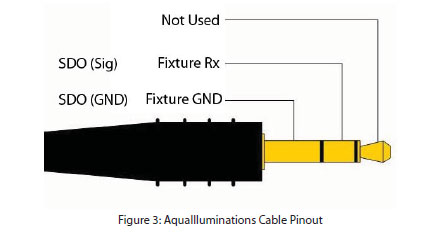

Re: LED's?
Here is what I found:
1- Although AI fixtures have 3 colors (White, Blue and Royal Blue), according to DA website, both blues are controlled together and not independently.
2- It does not use PWM, but Serial communication.
Here is the pinout from DA website:
Re: LED's?
Ok, it is confirmed.
The AI fixture uses very simple serial protocol at 9600 baud rate.
All 3 channels can be independently controlled.
We will need to test if the controller will be able to handle the streaming of data without the need of a coprocessor.
The main reason is the wifi attachment.
It could happen that the processor would be too busy handling the data stream and would drop wifi data and vice-versa. That's why I decided to use a coprocessor for the Vortech module.
But with the AI, the stream is much shorter and much slower, so we may be able to pull it off.

Re: LED's?
Ok, so I had some time to go reasearch on why my 1st attempt was not successful and I realized that I missed an interesting point.
On my haste and excitement that they were using serial communication, I forgot to measure the voltage they are using.
According to the data I sniffed from their controller, they are using a very odd and non-standard serial protocol. They are inverting everything, which doesn't make sense.
Unless they actually using real RS-232 logic levels, instead of TTL levels.
So, I'm going to hack the code to invert the signals and head out to test again tomorrow.
Re: LED's?
I guess I just found out the answer of the inverted signal.
It does look like they indeed use RS-232 levels instead of UART levels
This is a photo from Neptunes website:
The cable connects to the serial port of their VDM module.

rimai wrote:I guess I just found out the answer of the inverted signal.
Once you had mentioned it being RS-232, this also made sense

Re: LED's?
So, I went to LFS today to measure the voltage and took an RA with me with the inverted UART signal.
I guess there is no need for additional hardware :o
This was my very crude attempt of thunderstorm, just to confirm that I could control it.
[youtube]http://www.youtube.com/watch?v=gDniy7FvF0A[/youtube]
So, I guess I'll work on creating a library for it and have some cables available at the webstore very shortly :mrgreen:
