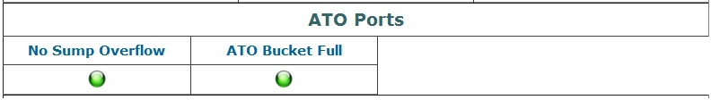

I doubt that it will help you with your Android coding, but I noticed that Roberto added the ability to customize the ATO status labels in the RA Portal.
RAPortal ATO Status.jpg (17.17 KiB) Viewed 8276 times

mudcat1 wrote:Curt,
That is good. I can pull those labels to be stored. I still have code in the ability to store and display the code but the portal labels can be downloaded and stored so you dont have to manually enter them.
What does the green circle mean and red circle mean? I know it has been posted before but I cant remember.
ATO Low: Red=open, green=closed
ATO Hi: Red=closed, green=open
I think. ;)

I'm adding in the ATO port displaying now. I'm initially just going to have TEXT labels displaying the status, then moving on to mimic the portal with the RED/GREEN dots.
Just to be clear (because I always forget these no matter how many times I ask),
ATO value of 1 means that it is ACTIVE or ON and the dot is GREEN
ATO value of 0 means that it is INACTIVE or OFF and the dot is RED
Is this correct or do I have things backwards? I'm thinking it is correct because that is how it is displaying for me on the portal but I wanted some confirmation.
binder wrote:I'm adding in the ATO port displaying now. I'm initially just going to have TEXT labels displaying the status, then moving on to mimic the portal with the RED/GREEN dots.
ATOHigh is reversed from ATOLow. It confuses the heck out of me.
