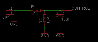

I would love to get one of these pumps going but don't have any free PWM ports, or do I?
I am using the Water level expansion so I do have the two ATO ports free and I seem to remember that they can provide a 0-5v PWM output.
I guess the question is would this output be sufficient to drive the the pump? If so how would the above code need to be changed to get the ATO ports in to use.
Re: Controlling Jebao/Tunze pumps
Only one ATO port can do PWM.
pinMode(lowATOPin,OUTPUT);
analogWrite(lowATOPin,ReefCrestMode(60,20,true)*2.55);
The cable is designed to work on 0-10VDC signals.
You will need to mod the cable if you want to use 0-5VDC signal.
Take one resistor and bridge the pads instead.
Edited: Pads do not need to be bridged. Only removal of resistor R2 is necessary
Sebyte
Post by Sebyte »
Thanks, I thought that was the case. As I have not seen the cable harnes I am not sure what you mean by bridge the pads?
Any chance of a circuit diagram?
Many thanks
Remove R2.
