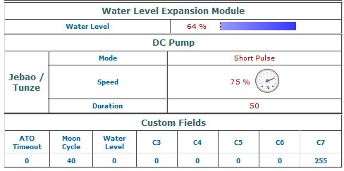

Hey Lee,
I added the custom to the list.
Can you confirm it works?
Re: JEBO WP-40
Yes, working fine, except I think you have the save / submit button tied to the Jaebo / DC screen..
I got these errors on the top where it shows the values that are being saved...
DC Pump Mode - ERR
DC Pump Speed - ERR
DC Pump Duration - ERR
And I would add a custom to the Jaebo as well so people can plug there own mode in.. we obviously have quite a few custom functions going on already...

daniella3d
Posts: 93
Joined: Wed Nov 14, 2012 8:34 pm
Re: JEBO WP-40
Post by daniella3d »
HI everyone, I just installed the jebao cable and uploaded the code but the short pulse mode does not work, wondering why?
I can hear the pump go into cycle but it seem to be going at 100% but never really stop, just slow down. What am I doing wrong? With the jebao controller the W1 mode, short pulse, the pump goes to 100%, then completele stop, then 100% then stop. You can actually see the propeller stops. With the RA it never really stop??
the code I am using:
ReefAngel.PWM.SetDaylight( ShortPulseMode(0,100,500,true) ); // Short pulse at 60% with 200ms pulse on sync mode
