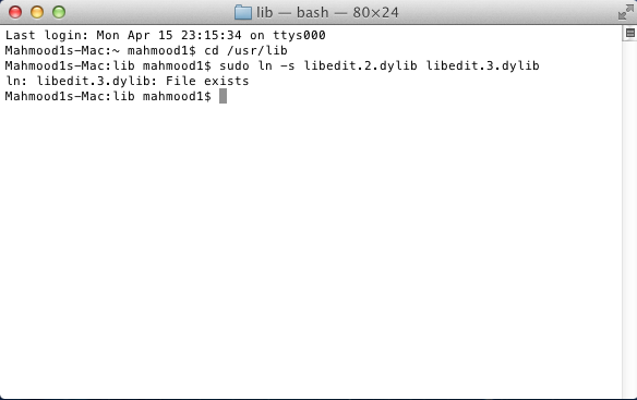

Re: Uploading code to RA plus on MBP
Oh no...
not libraries for arduino...
you need to type them exactly as it is posted above.
Like this:
- terminal.png (16.87 KiB) Viewed 7477 times
