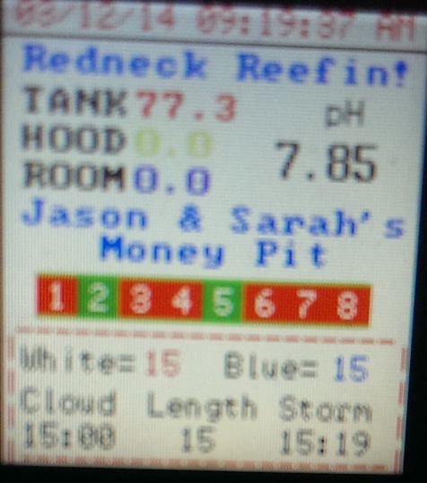

The alignment is off.
You will need to align them perfect just like it was before.
Re: Clouds and Lightining Effects using standard PWM channel
got them to line up i think? What exactly is this determining? The time before the next cloud?
It reads 29:00 right now
If I'm reading this right...it states, "14:29" thus my next cloud is at 2:29pm? Or am I way off?
yeah. whatch and see if it is correct
It works...going to post a video soon
Ramp from cloud and back...showed 12 min duration (perfect) and next cloud due at 1553
AWESOME!
Of course the phone's camera has no white balance nor does it show shimmer very well from the LEDs
And new main showing next cloud and next duration (in minutes)....

I think I broke something my storm is after the clouds is that right?

  if (LastNumMins!=NumMins(hour(),minute()))
    LastNumMins=NumMins(hour(),minute());
    ReefAngel.LCD.Clear(255,0,120,132,132);
    ReefAngel.LCD.DrawText(0,255,8,108,"Cloud");
    ReefAngel.LCD.DrawText(0,255,8,118,"00:00");
    ReefAngel.LCD.DrawText(0,255,90,108,"Storm");
    ReefAngel.LCD.DrawText(0,255,48,108,"Length");
    ReefAngel.LCD.DrawText(0,255,90,118,"00:00");
    if (cloudchance && (NumMins(hour(),minute())<cloudstart))
      int x=0;
      if ((cloudstart/60)>=10) x=8; else x=14;
      ReefAngel.LCD.DrawText(37,255,x,118,(cloudstart/60));
      if ((cloudstart%60)>=10) x=58; else x=64;
      ReefAngel.LCD.DrawText(37,255,x,118,(cloudstart%60));
    if (lightningchance)
      int x=0;
      if (((cloudstart+(cloudduration/2))/60)>=10) x=90; else x=96;
      ReefAngel.LCD.DrawText(37,255,x,118,((cloudstart+(cloudduration/2))/60));
      if (((cloudstart+(cloudduration/2))%60)>=10) x=108; else x=114;
      ReefAngel.LCD.DrawText(37,255,x,118,((cloudstart+(cloudduration/2))%60));
