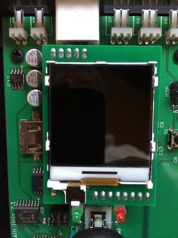

Due to different manufacturers of the screen we use, the driver used is also different and it will require a line of code to be added if you are having issues when you install a new screen.
Below are the screen with their respective code that needs to be added.
The line needs to be added right above ReefAngel.Init(); to make sure the controller knows which gen screen you are using
Gen 1
Dark brown pcb connector and black bottom
gen 1.jpg (8.15 KiB) Viewed 46088 times
  InternalMemory.LCDID_write(255);
Gen 2
Tan or green pcb connector and white bottom
gen 2.jpg (8.22 KiB) Viewed 46088 times
Gen 3
No pcb connector and black bottom
gen 3.jpg (7.37 KiB) Viewed 46088 times
  InternalMemory.LCDID_write(0);
Gen 4
No pcb connector with flex going through a cutout
gen 4.jpg (12.39 KiB) Viewed 43159 times
  InternalMemory.LCDID_write(1);

Re: LCD screen hardware change
Yeah it was easy. It just came out and the new one went in it's place. Just make sure the pins are lined up and it doesn't need any force. If you feel that it is hard, stop, pull it off and check everything is straight and aligned.
Mine came up fine with out having to replace the code.

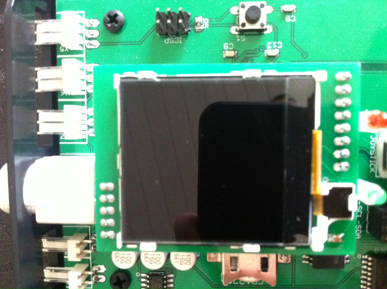

Post by OceanWolf »
Hi Roberto,
I think I have a Gen2. What should I do?
Onur
RA Plus LCD Screen
RA Plus LCD Screen
Onur
Yeap.
PM me for RMA.
