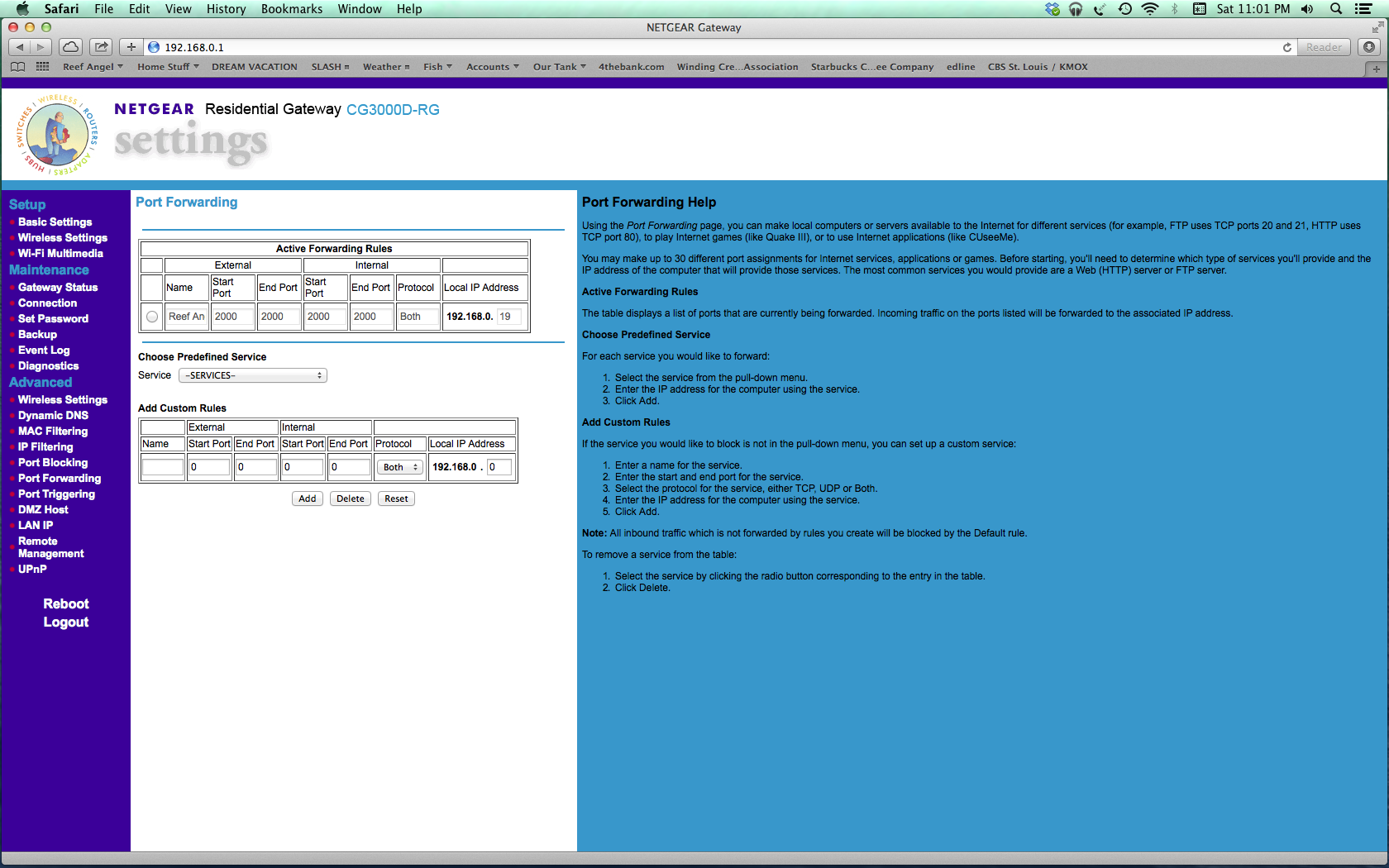

So is this correct?
Screen Shot 2014-01-18 at 11.01.35 PM.png (354.55 KiB) Viewed 5057 times
Kevin
ReEfnWrX
Posts: 232
Joined: Tue Nov 05, 2013 8:40 am
Location: Houston TX
Re: Unreachable Address
Post by ReEfnWrX »
That is correct as far as port forwarding goes. The issue you are having is the Wifi unit is being assigned random IP addresses. You need to assign a static IP address to the wifi units mac address in your DHCP settings so it will always have the same IP address...

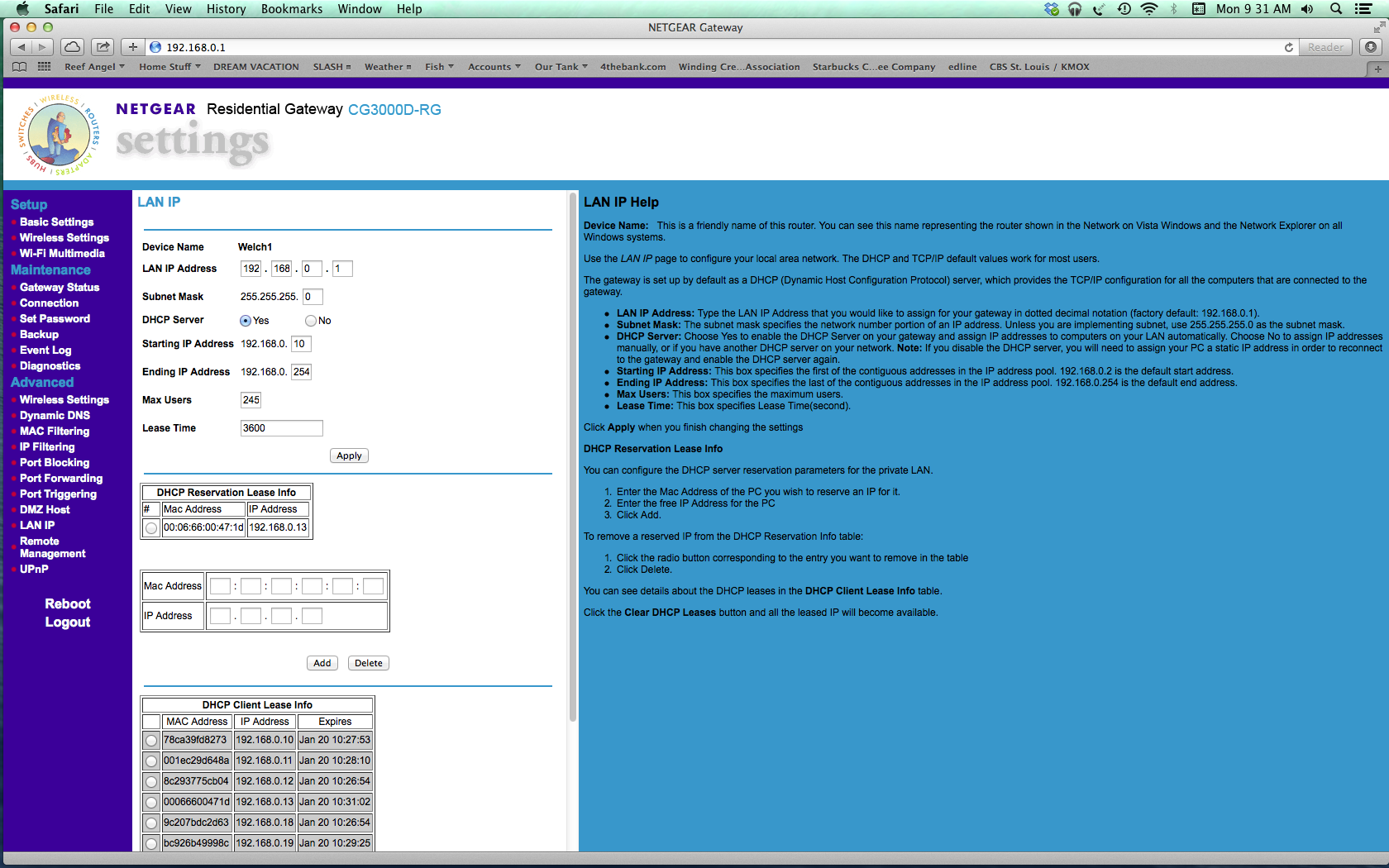

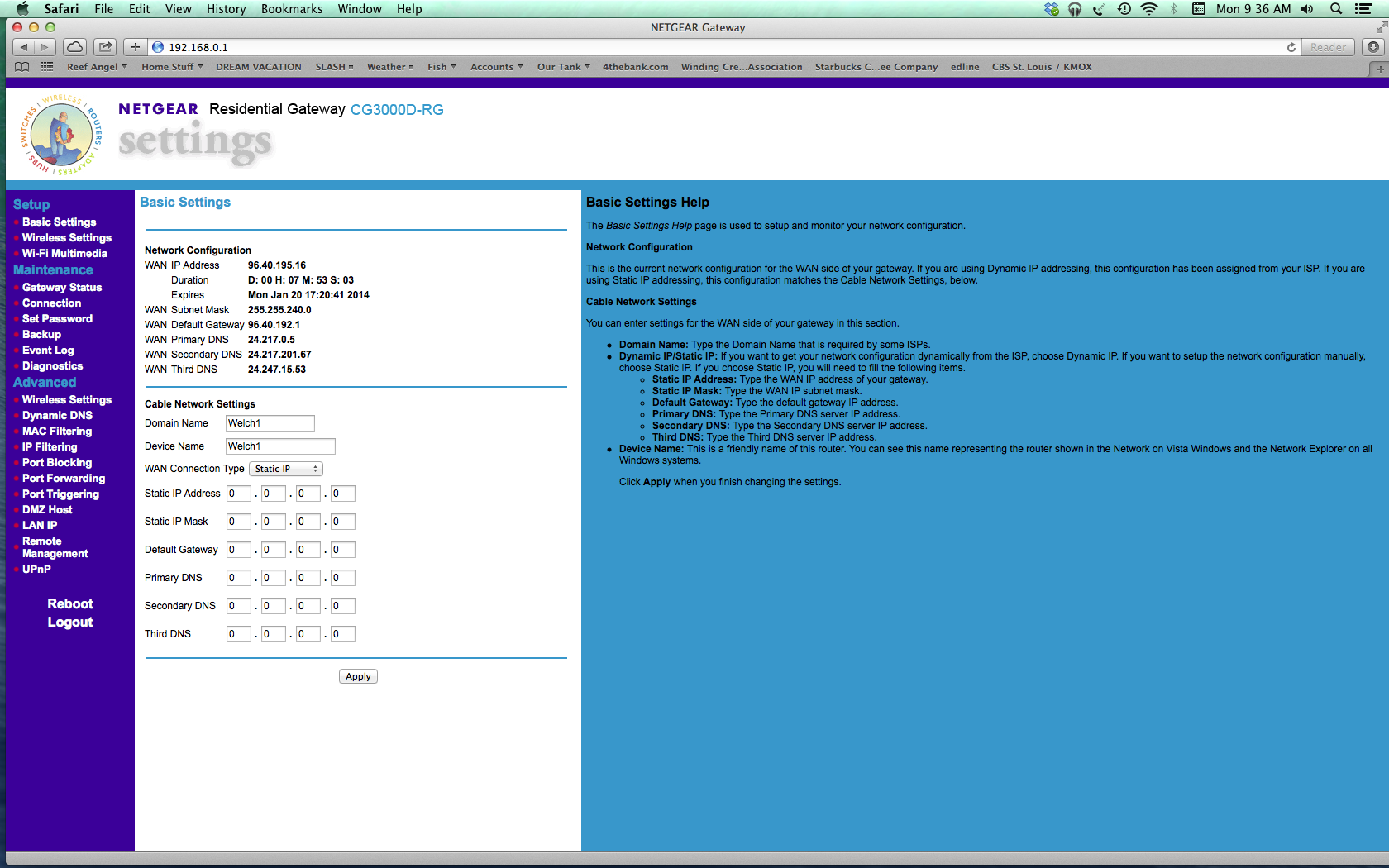

Wifi Utility said my address was : 192.168.0.13
So based on his screen shot is that now static??
This is getting old fast!
Screen Shot 2014-01-20 at 9.31.56 AM.png (446.61 KiB) Viewed 4521 times
Kevin
kmw504
Posts: 15
Joined: Sat Dec 21, 2013 5:59 pm
Location: St Louis
Post by kmw504 »
or am I supposed to do something here?
Screen Shot 2014-01-20 at 9.36.10 AM.png (388.9 KiB) Viewed 4521 times
Kevin
The first one looks good. The second is for your cable connection leave that one alone.
