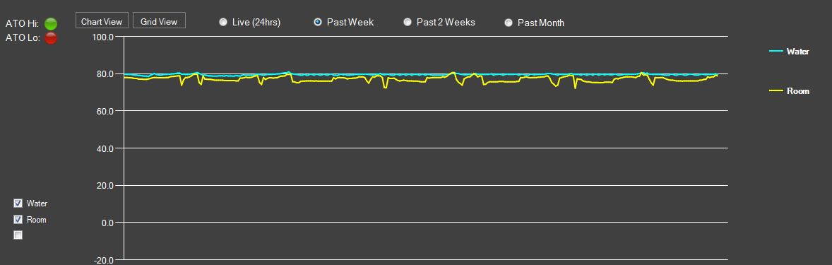

At exactly 5pm, the RA went into an overheat condition with red LED on. I checked to see if it was an ATO alarm as 5pm is the end of one of the ATO available periods. But it needed the overheat to be reset. The tank was 80.4*f and the room 76.5*f, so nothing was overheating.
The lamps and skimmer shutdown and the canceling of the overheat brought them back on.
The strange thing was that the wifi was unavailable to the client app as well as the iPAD app. I had to do a hard reset to clear the condition. (unplug from mains)
I am concerned that should this happen when I am not around, and I do travel away from home for several days at atime, the tank will drop temperature and the lamps will stay off. If the wifi has also become unavailable I would not be able to reset things remotely. This was the main reason for getting RA.
Any advice will be very welcome.

As soon as I put the probe in the Coffey RA went into an overheat. I cooled the probe and did a reset. Then to take things more slowly I griped the probe in my hand and watched the temperature change on my iPAD. At 85 we has an overheat trip.
I have looked at the temperatures for the past week in the client suit (see attached graph) and the temperature for both probes has never reached 85*f When you hover the mouse pointer over the displayed temperatures in the client they display as follows.
Water (Temp1) Min-00 Max-81.1 Ave-78.9
Room (Temp2) Min 00 Max 80.7 Ave 76.6
Temperatures last week.JPG (41.46 KiB) Viewed 7345 times

// ATO available 6 times per day - 00:00 to 01:00, 04:00 to 05:00, 08:00 to 09:00, 12:00 to 13:00, 16:00 to 17:00, 20:00 to 21:00,
  if (hour() % 4 == 0 && ReefAngel.LowATO.IsActive()) //Rev made 19/11/11
    ReefAngel.Relay.On(Port2);
    ReefAngel.Relay.Off(Port2);
