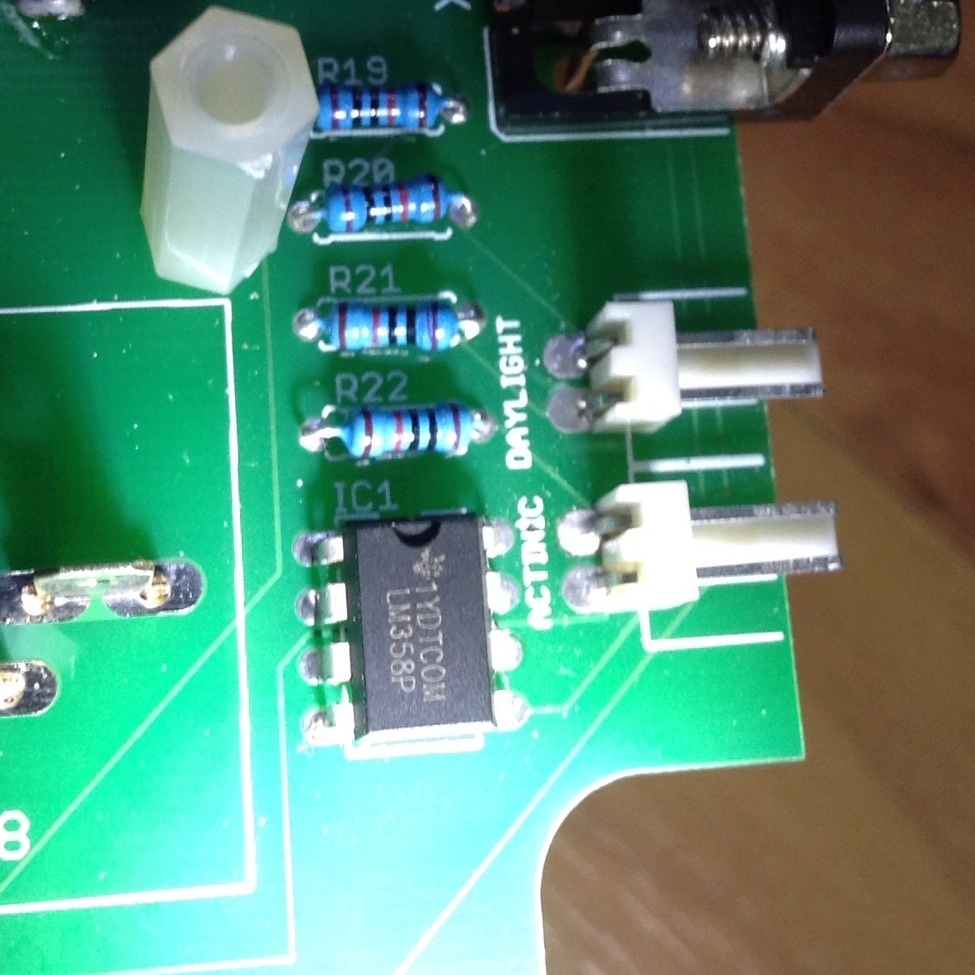

Re: Daylight PWM port not working
I think the op amp is bad.
LM358 inside the relay box.

rimai wrote:I think the op amp is bad.
I had a similar problem with the relay box, where the dimming channels were not working. Roberto advised that I change chip LM358P on the relay board. I did that and the dimming channels were functioning after that.
Location of chip.
