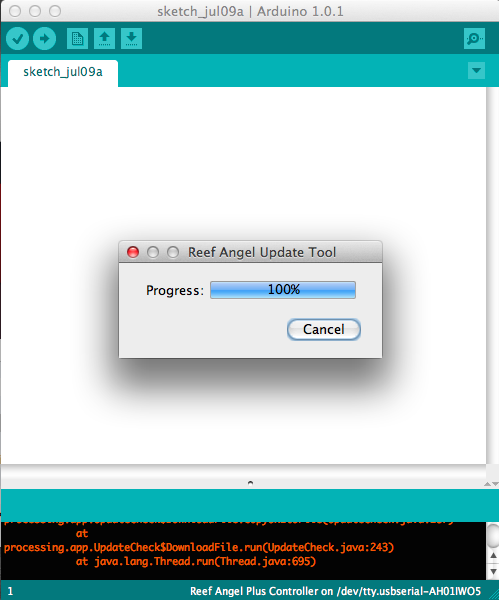

I have some more info for you.
I opened another copy of Arduinio on my computer - it asked if I wanted to upgrade to the latest library and I said yes... it went all the way to 100% progress and crashed here:
Updating /libraries/NokiaLCD/README
Updating /libraries/OneWire/keywords.txt
Updating /libraries/OneWire/OneWire.cpp
java.io.IOException: Server returned HTTP response code: 503 for URL: https://raw.github.com/reefangel/libraries/master/OneWire/OneWire.cpp
at sun.net.www.protocol.http.HttpURLConnection.getInputStream(HttpURLConnection.java:1459)
at sun.net.www.protocol.https.HttpsURLConnectionImpl.getInputStream(HttpsURLConnectionImpl.java:234)
at java.net.URL.openStream(URL.java:1010)
at processing.app.UpdateCheck$DownloadFile.copyURLtoFile(UpdateCheck.java:274)
at processing.app.UpdateCheck$DownloadFile.run(UpdateCheck.java:243)
at java.lang.Thread.run(Thread.java:695)
Exception in thread "Thread-7" java.lang.NullPointerException
at sun.nio.ch.FileChannelImpl.transferFrom(FileChannelImpl.java:581)
at processing.app.UpdateCheck$DownloadFile.copyURLtoFile(UpdateCheck.java:287)
- Screen Shot 2014-07-09 at 8.38.58 PM.png (64.62 KiB) Viewed 15307 times
