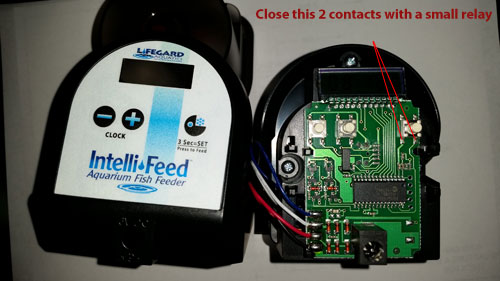

The feeder that apex uses is from lifegard aquatics.
http://www.lifegardaquatics.com/product ... sh-feeder/
It's pretty simple to mod it too.
All you need is a small relay to close those 2 contacts to simulate the press of the button. :)

rimai wrote:The feeder that apex uses is from lifegard aquatics.
What relay would you recommend?

Roberto, what specific relay would you recommend on the intelli-feeder?
Re: Controllable Automatic Fish Feeder?
Use something like this to be safe:
http://m.ebay.com/itm/310566336050?nav=SEARCH

Are you shorting the output of the relay to simulate a button press or applying voltage?
The way it has been done on the Ehiem Auto Feeder is we are applying 12v current to a relay that in turn is closing the connection for the feeder button and rotating the feeder chamber. Simulating a push of the button.

I think I understand, you're using a relay to activate their relay?
Yes, if they are using a relay.
