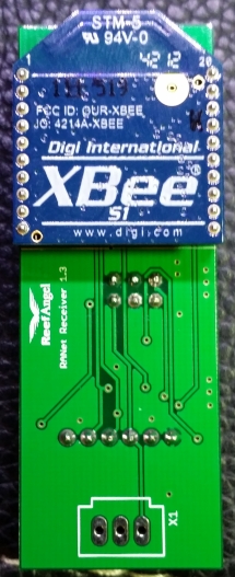

Re: RANet relay expansion not working

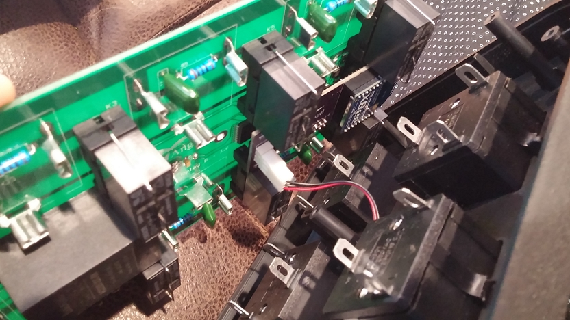

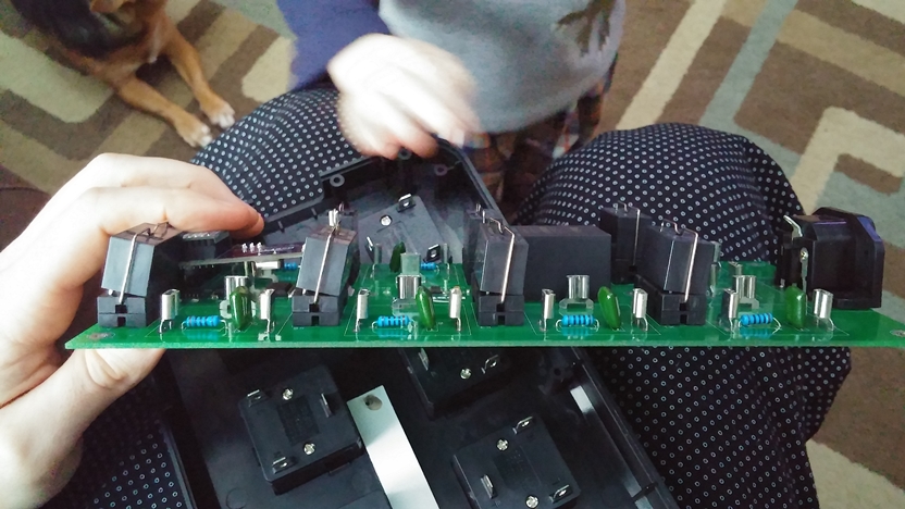

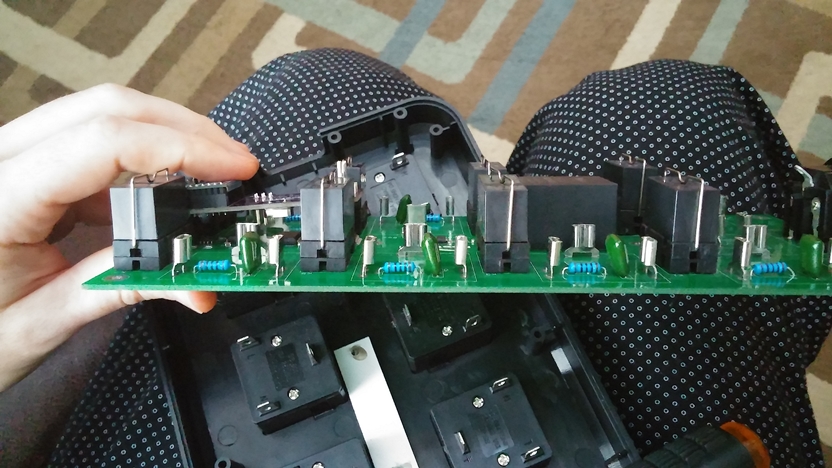

Open the enclosure box
Remove all screws to free up the board inside.
You should be able to pry the board from the outlets.
Pay attention to the Logo LED lead wires. Make sure to disconnect when separating the pcb from the outlets/box.

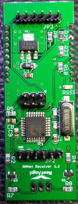

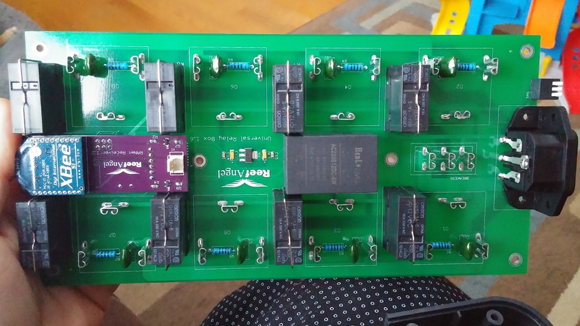

With the pcb in your hand, you will see the RANet Receiver
Detach and look underneath. One of the 6pin headers has a GND marking. That's the black wire of the programming cable you use to program RA.

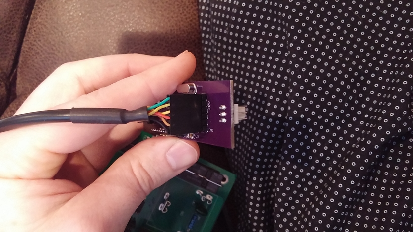

Connect the programming cable to the RANet Receiver.
Go to Arduino and make sure to change the board to ReefAngel w/ optiboot
Load the code below to the RANet Receiver.
I just happen to have a pic of the RANet receiver. This is what you're looking for.
RANet Receiver.jpg (185.94 KiB) Viewed 10685 times

rimai wrote:Open the enclosure box

I just did this. We'll see if it helps.
Here are some pictures for others in the future:
"You should be able to pry the board from the outlets."
I was a little disappointed to see that ALL of these black boxes were not pushed onto the board all the way
there fixed it
"Pay attention to the Logo LED lead wires. Make sure to disconnect when separating the pcb from the outlets/box."
continued below...
"With the pcb in your hand, you will see the RANet Receiver"
"Detach and look underneath. One of the 6pin headers has a GND marking. That's the black wire of the programming cable you use to program RA."
"Connect the programming cable to the RANet Receiver."
