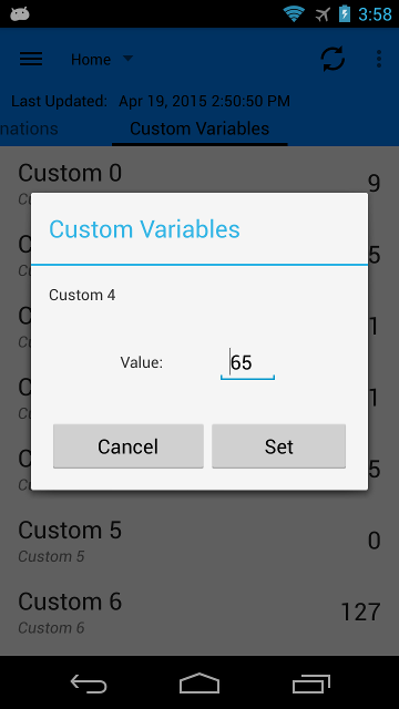

AlanM wrote: - Can there be a way to set custom variables when those are enabled by holding on the value just like you do with dimming and dc pump? You'd just need to call the url "http://dns:2000/cvar1,150" or whatever it is set to and watch for the OK to come back similar to the other overrides, I think.
Did you want a slider bar to choose a value between 0-255 or would you rather an edit box to type in the value?
I think for what Alan is doing he'd want the edit box. I like the slider bars in the Universal App, but it's hard to set a specific number with them.... just my $.02.
lnevo wrote:I think for what Alan is doing he'd want the edit box. I like the slider bars in the Universal App, but it's hard to set a specific number with them.... just my $.02.
yeah, I was thinking about that too. Sliders look nice but can be hard to set the exact number you want.
So, I went with this instead:
custom var popup.png (36.83 KiB) Viewed 13454 times
I finished up a few things and am getting closer to an official release.
For now, I have to drop support for devices below Android 4.0 (sdk 15). It has to do with the preferences and the new material toolbar. I might be able to bring back support to older versions in the future but we will just have to see.
Here's a highlight of the changes from Beta 2:
  • Added Custom variable value setting (this is for you Alan)

AlanM
Posts: 263
Joined: Wed Jan 01, 2014 7:26 am
Post by AlanM »
That way of doing cvar numbers is perfect. Just like the other memory locations. It also would have been fine to just increase the list of memory locations in that dialog to include the locations that hold the cvar values. Thanks, Curt. It saves me from trying to push in numbers via url by typing it out in the url location and hoping I get the right internal ip address.
The worst part of doing it in the browser is sometimes the entry gets cached (in my mobile browser) and then loading the page later triggers it to make the api call which sometimes is not what I want. :(
