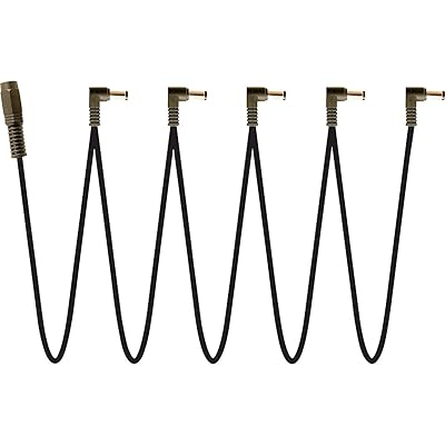

On Amazon, I see a variety of similar barrel plug daisy chain devices, which adapt a single male barrel plug (like those on the 12V wall warts included with various expansion modules) to multiple plugs.
It seems like connecting a single, sufficiently powerful 12V adapter to all of the expansion boxes (e.g., the ORP expansion, the salinity expansion, the I/O expansion, and the two 16-channel dimming expansions in my setup) would solve some wall wart clutter, and possibly reduce the vampire power draw of these devices.
So my question is, what is the power draw of these various devices? I assume that the included wall warts are sized so generously that I could get away with less than 5x their rated power, but I'd like to be sure. Does anyone know the actual draw? Would it pose a problem for the resistive heating of the daisy chain cable?
