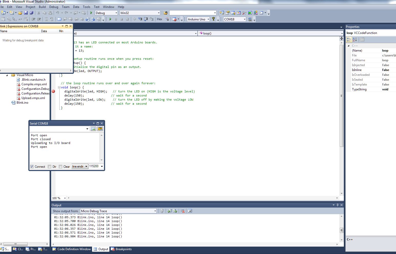

As you can see here is the simple Arduino Blink example being debugged, it compiled fully and uploaded to my UNO using Visual Studio and the plugin.

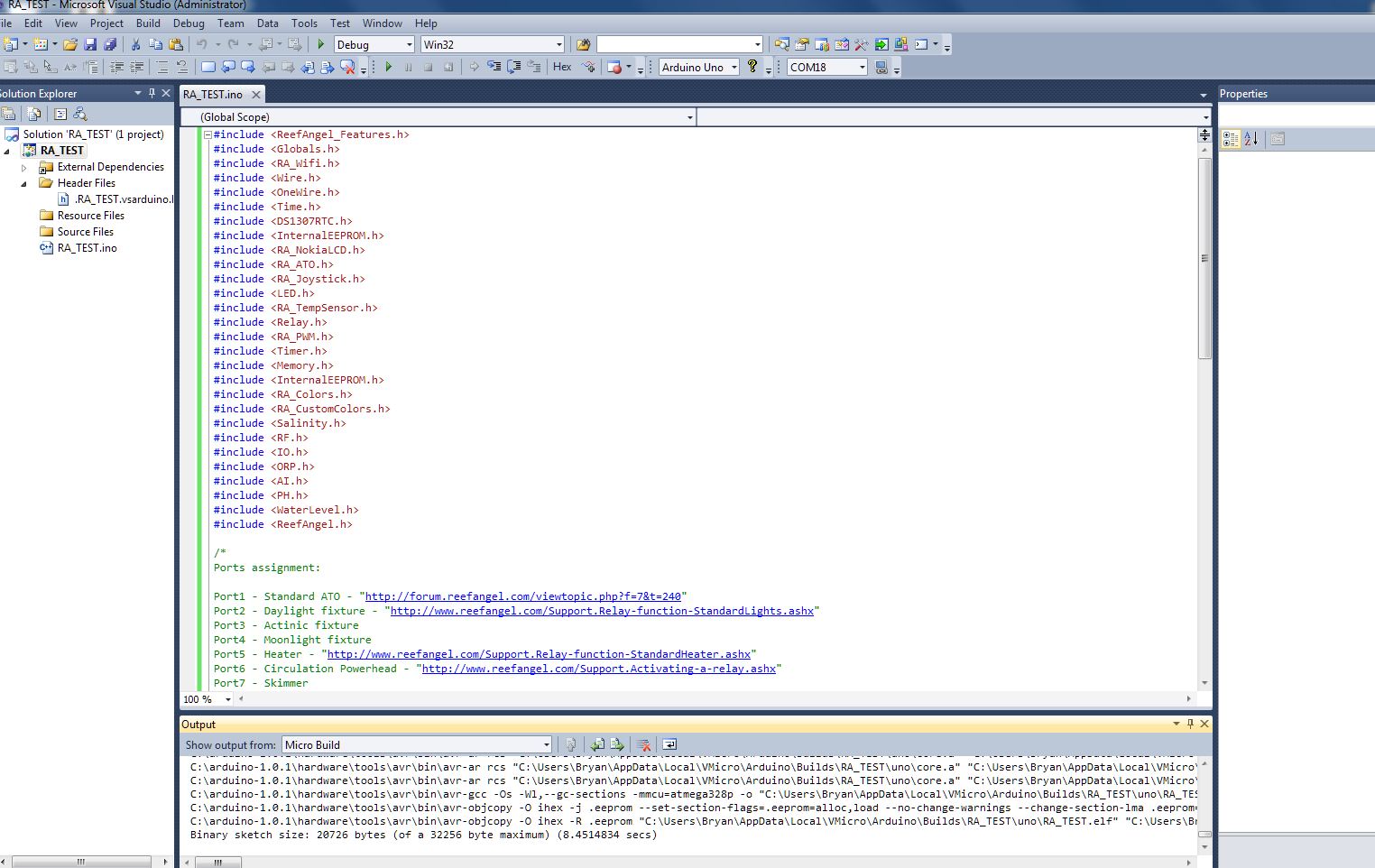

As well the Reef Angel ExampleCode 1 sketch easily compiled. Unfortunately I don't USB to TTL cable so could not confirm that it would upload correctly to the ReefANgel. I can not see why it would not. I can upload the *.hex using my AVR dragon and ISP and it is fine, but can not debug with the Dragon setup.

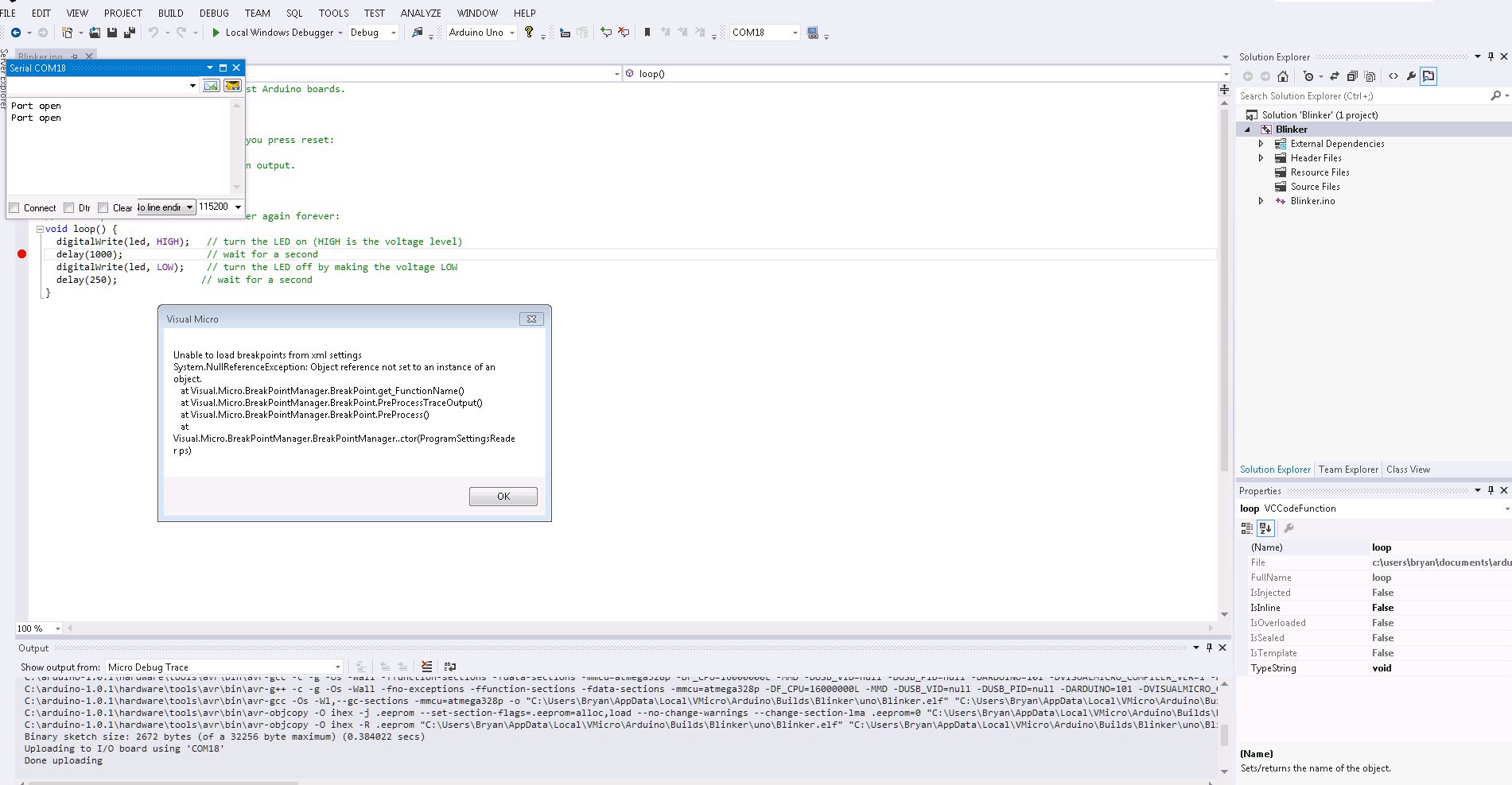

Was able to get the plugin installed in VS2102. Compiles code and uploads fine, but seems to be a isue with debugging. Getting there anyway. :D
