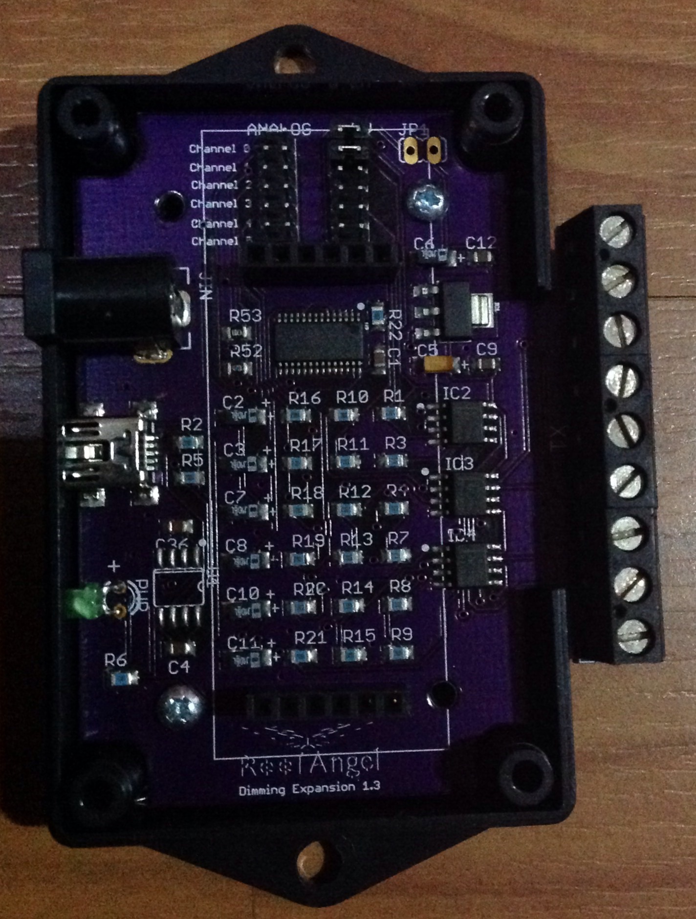

I have a RANet wireless relay box and wireless dimming module. Both are not working now. I have a few items connected to the wireless relay box. Since the box does not communicate and sync with the main head unit, can it be connected to the main unit through an expansion hub, which is in turn connected to the 1st non wireless relay box? I dont think the relay expansion module will work as it only has a SVGA connector. The wireless relay box on the other hand only has a micro usb connector. I need to have control over the wireless relay box. Can the same be applied to the wireless dimming module?

Re: RANet Add-On
The relay box can be connected to the hub just fine with a regular usb cable.
You just need to power it off and back on with the cable connected.
The dimming may work the same depending on how the module was built. Send me a photo of the dimming module or check if U1 is populated.

rimai wrote:The relay box can be connected to the hub just fine with a regular usb cable.
Re: RANet Add-On
U1 is not there, which means you won't be able to connect the dimming directly using USB cable.
