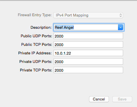

Portal shows the correct IP address as does the app. I can reach the RA onboard webserver from inside and outside of my local network. Here's a picture of my port forwarding setup. Seems OK to me....
Reef Angel wifi address: <My IP>
My reefangelid:icecool2
Connection Status:Unreachable Address
Last Update: 9/25/2015, 5:53:31 AM
Displaying data from: Webbanner database
- Screen Shot 2015-09-25 at 6.03.15 AM.png (38.11 KiB) Viewed 4396 times
Re: Wifi Utility for Mac Broken?
Yeah, it looks good.
PM me your ip address, so I can try connecting to the unit and see if I can get connection.
