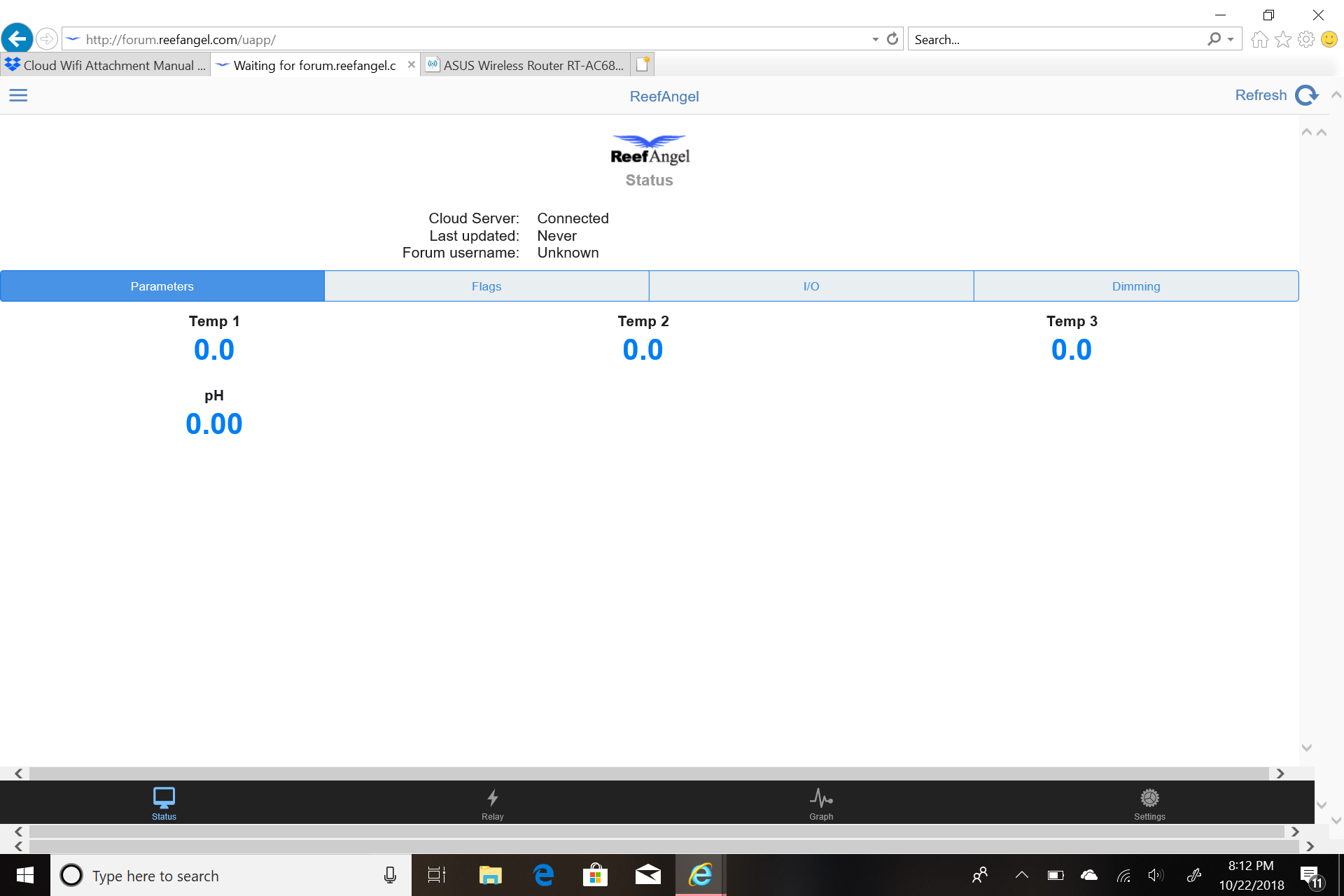

I have loaded the code and it has been in a state of trying to connect for an hr. constant solid currently. It owuld blink occasionally when i first plugged it in.
Re: Cloud Wifi Attachment
Can you pull log again?

I re uploaded as well reset the whole system and it is functioning now

No it's doing as in my second to last post on page 4. It stays green until I plug in the USB into a computer or wall outlet. Then it acts as if it resets itself so I can't serial monitor it. I had left it connected to just the reef angel since the 8th and it stayed connected until the 11th and had been solid green since then as I am out of the country and have a house sitter telling me the color of the light.
If you are getting this: "Attempting to connect to Network named:
Not connected..."
Your code is wrong. It doesn't have the SSID name.

It does connect and I have verified data going to the U-App. The problem is after a time it goes to green light only, It's acting as if it locks up. My previous posts explain the steps I've taken after it locks up.
How far is it from router?
I wonder if it is loosing the connection.

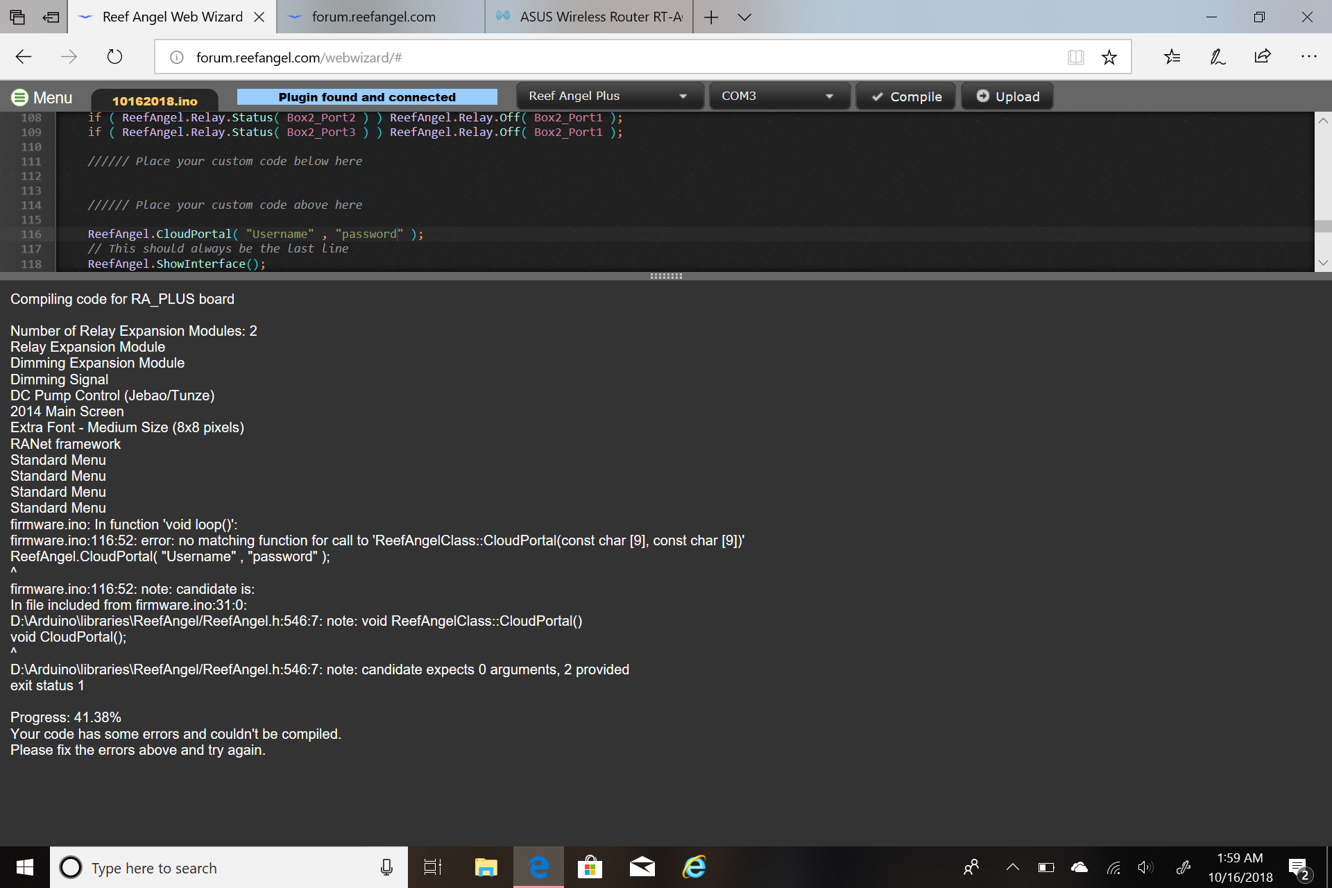

Am Getting an error trying to compile...I have the latest Dev library.
My_RA_Version_3_0.cpp: In function 'void loop()':
My_RA_Version_3_0:372: error: 'class ReefAngelClass' has no member named 'CloudPortal'

  // Display LED %
  //ReefAngel.LCD.DrawText(0,255,12,92, "CW:");
  //ReefAngel.LCD.DrawText(197,255,32,92, ReefAngel.PWM.GetDaylightValue());
  //ReefAngel.LCD.DrawText(0,255,72,92, "RB:");
  //ReefAngel.LCD.DrawText(3,255,92,92, ReefAngel.PWM.GetActinicValue());
  // Display Relays
  ReefAngel.LCD.DrawOutletBox(12, 102, TempRelay);
    ReefAngel.LCD.DrawGraph(5, 12);
/*void SeasonalTemps ()
  static int heatArray[][2] = { {792,796},// default in case of error in month=0 (June)
                    {770,774},//January (winter)
                    {774,778},//February (winter)
                    {775,779},//March (early spring)
                    {779,783},//April (spring)
                    {785,789},//May (spring)
                    {792,796},//June (early summer)
                    {799,803},//July (summer)
                    {806,810},//August (summer)
                    {796,800},//September (early fall)
                    {787,791},//October (fall)
                    {780,784},//November (fall)
                    {775,779} };//December (early winter)
  ReefAngel.StandardHeater( Port2,heatArray[month()][0],heatArray[month()][1]);
    //ReefAngel.Use2014Screen();  // Let's use 2014 Screen
    ReefAngel.AddSalinityExpansion();
    // Default Salinity compensation
    ReefAngel.Salinity.SetCompensation(0);
    ReefAngel.FeedingModePorts = Port3Bit| Port5Bit | Port6Bit ;
    ReefAngel.WaterChangePorts = Port2Bit | Port3Bit | Port5Bit | Port6Bit;
    ReefAngel.LightsOnPorts = Port7Bit | Port8Bit;
    ReefAngel.OverheatShutoffPorts = Port2Bit;
    ReefAngel.Relay.On( Port2 );
    ReefAngel.Relay.On( Port3 );
    ReefAngel.Relay.On( Port4 );
    ReefAngel.Relay.On( Port5 );
    ReefAngel.Relay.On( Port7 );
  //sl.Init(-21.285833, 150.999722); // In decimal numbers (i.e. -18.285833, 147.699722)
  //sl.SetOffset(11,0,11,0); // rise_hour, rise_seconds, set_hour, set_seconds
    sl.Init(38.8447,-104.8433); // Colorado Springs,CO In decimal numbers (i.e. -18.285833, 147.699722)
    sl.SetOffset(-6,0,-6,0); // rise_hour, rise_seconds, set_hour, set_seconds
  randomSeed(now()/SECS_PER_DAY);
  //if (InternalMemory.read(Mem_B_ResetMemory))
    //init_memory();
        //Temp Code for Fuge Light
    //ReefAngel.StandardLights( Port5,sl.GetSetHour(),sl.GetSetMinute(),sl.GetRiseHour(),sl.GetRiseMinute() );
    //ReefAngel.StandardLights( Port7,sl.GetSetHour(),sl.GetSetMinute(),sl.GetRiseHour(),sl.GetRiseMinute() );
    // 15min Delay on Skimmer coming from Feeding oe Waterchange Modes
    ReefAngel.Relay.DelayedOn(Port3, 10);
    // Custom Variable for Portal
    ReefAngel.CustomVar[Var_weekday]=weekday();
    //Heater
    //SeasonalTemps();
    // Jebao Code
    // Feeeding and Water Change mode speed
    ReefAngel.DCPump.FeedingSpeed=0;
    ReefAngel.DCPump.WaterChangeSpeed=0;
    pinMode(lowATOPin,OUTPUT);
    analogWrite(lowATOPin,ReefCrestMode(50,20,true)*2.55);
    ReefAngel.DCPump.UseMemory = true;
    ReefAngel.DCPump.LowATOChannel = AntiSync ; // Jebo connected to AtoPINLow
    pinMode(highATOPin,OUTPUT);
    analogWrite(highATOPin,ReefCrestMode(50,20,true)*2.55);
    ReefAngel.DCPump.HighATOChannel = AntiSync ; // Jebo connected to AtoPINLow
    // Add random mode if we set to Mode to Custom in portal
    static int rmode;
    static boolean changeMode=true;
    // These are the modes we can cycle through. You can add more and even repeat...
    byte modes[] = { Lagoon, ReefCrest, TidalSwell, Sine, Gyre, NutrientTransport, Else };
    if (now()%SECS_PER_DAY==0 || changeMode==true) { // Change at midnight or if controller rebooted
    rmode=random(100)%sizeof(modes); // Change the mode once per day to pick from our array
    changeMode=true;
    // Set timer when in feeding mode
    static unsigned long feeding;
    if (ReefAngel.DisplayedMenu==FEEDING_MODE) feeding=now();
    if (now()-feeding<900) {
      // First 15 minutes after feeding mode stops. Smart_NTM
      ReefAngel.DCPump.UseMemory=false;
      ReefAngel.DCPump.Mode=NutrientTransport;
    } else if (now()-feeding<2250) { // 15 minutes plus 1 hour
      // Continue NTM for the next 60 minutes (75 minutes total)
    } else if (now()%SECS_PER_DAY<23400 || now()%SECS_PER_DAY>=72000) { // 6:30am / 8:00pm
      // Night mode (go to 30%)
      ReefAngel.DCPump.Mode=Constant;
      ReefAngel.DCPump.Speed=32;
      //ReefAngel.DCPump.SetMode(Constant,31,45,30);
    } else if (InternalMemory.DCPumpMode_read()==11) {
      // Custom Mode and nothing else going on
      ReefAngel.DCPump.Duration=InternalMemory.DCPumpDuration_read();
      if (modes[rmode]==Else) {
        ReefAngel.DCPump.Speed=ElseMode(InternalMemory.DCPumpSpeed_read(),25,true );    // ElseMode on sync mode, Portal Speed Setting +/- 25%
      } else {
        ReefAngel.DCPump.Mode=modes[rmode];  // Put the mode to the random mode :)
        ReefAngel.DCPump.Speed=InternalMemory.DCPumpSpeed_read(); // Set speed from portal
    } else {
      ReefAngel.DCPump.UseMemory=true; // Will reset all values from memory
////////// Variables used for all channels
  byte acclDay = InternalMemory.read(Mem_B_AcclDay);
// What day in the acclimation cycle it is
  byte acclDuration = InternalMemory.read(Mem_B_AcclDuration);
// Acclimation Duration in days
  byte startPercent = InternalMemory.read(Mem_B_SlopeStart);
// Normal start% being used by all 3 channels
////////// Blue Channel Variables
  byte acclStartEndBlue = InternalMemory.read(Mem_B_AcclStartEndBlue);
// Starting End% for Acclimation cycle
  float acclendPercentBlue = InternalMemory.read(Mem_B_SlopeEndBlue);
// Your target Blue end% once acclimation is complete
////////// Blue Channel Formula
  float acclPercentPerDayBlue = (acclendPercentBlue - acclStartEndBlue) / acclDuration;
// How much your Blue end% rises per acclimation day
  float acclFactorBlue = acclDay * acclPercentPerDayBlue;
// endPercentBlue will be offset by this much. If acclDay = 0 then this value will be 0
  byte endPercentBlue = acclendPercentBlue - acclFactorBlue;
// Your final Blue end% for the day
////////// White Channel Variables
  byte acclStartEndWhite = InternalMemory.read(Mem_B_AcclStartEndWhite);
  float acclEndPercentWhite = InternalMemory.read(Mem_B_SlopeEndWhite);
// Your target White end% once acclimation is complete
////////// White Channel Formula
  float acclPercentPerDayWhite= (acclEndPercentWhite - acclStartEndWhite) / acclDuration;
// How much your White end% rises per acclimation day
  float acclFactorWhite = acclDay * acclPercentPerDayWhite;
// endPercentWhite will be offset by this much. If acclDay = 0 then this value will be 0
  byte endPercentWhite = acclEndPercentWhite - acclFactorWhite;
ReefAngel.CustomVar[Var_AcclDay]=acclDay;
// At the end of the day, we need to decrement the acclimation counter.
  static boolean acclCounterReady=false; // We need a boolean so we only do this once per day
  if (now()%SECS_PER_DAY!=0) acclCounterReady=true; // If it's not midnight we'll get the boolean ready
  if (now()%SECS_PER_DAY==0 && acclCounterReady && acclDay>0) { // It's midnight, our bool is true and acclDay is more than 0
    acclDay--; // Reduce the counter
    acclCounterReady=false; // Reset the boolean flag
    InternalMemory.write(Mem_B_AcclDay,acclDay); // Update memory
    // handle updating sunrise and sunset values
    sl.CheckAndUpdate();
    //ReefAngel.Portal( "89delta","collin1123" );
    //ReefAngel.DDNS( "bc29" ); // Your DDNS is 89delta-bc29.myreefangel.com
    ReefAngel.CloudPortal();
  // Calculate your regular sunrise/sunset PWM value
  ActinicPWMValue=PWMSlope(sl.GetRiseHour(),sl.GetRiseMinute(),sl.GetSetHour(),sl.GetSetMinute(),startPercent,endPercentBlue,120,(MoonPhase()/3));
  DaylightPWMValue=PWMSlope(sl.GetRiseHour(),sl.GetRiseMinute(),sl.GetSetHour(),sl.GetSetMinute(),startPercent,endPercentWhite,120,DaylightPWMValue);
  CheckCloud();
  ReefAngel.PWM.SetActinic(ActinicPWMValue);
  ReefAngel.PWM.SetDaylight(DaylightPWMValue);
// RA_STRING1=U2FsdGVkX19/CQXYxFHutorfRImY8TNubevs+8+6Sjw=
// RA_STRING2=U2FsdGVkX1+7EBoxpKZdEtYXEBfHD+fIe5qrAeDKTa8=
// RA_STRING3=Gundel
// RA_LABEL LABEL_ACTINIC=Actinic
// RA_LABEL LABEL_DAYLIGHT=Daylight
// Random Cloud/Thunderstorm effects function
void CheckCloud()
  // Change the values below to customize your cloud/storm effect
  // Frequency in days based on the day of the month - number 2 means every 2 days, for example (day 2,4,6 etc)
  // For testing purposes, you can use 1 and cause the cloud to occur everyday
#define Clouds_Every_X_Days 1
  // Percentage chance of a cloud happening today
  // For testing purposes, you can use 100 and cause the cloud to have 100% chance of happening
#define Cloud_Chance_per_Day 50
  // Minimum number of minutes for cloud duration.  Don't use max duration of less than 6
#define Min_Cloud_Duration 6
  // Maximum number of minutes for the cloud duration. Don't use max duration of more than 255
#define Max_Cloud_Duration 15
  // Minimum number of clouds that can happen per day
#define Min_Clouds_per_Day 3
  // Maximum number of clouds that can happen per day
#define Max_Clouds_per_Day 10
  // Only start the cloud effect after this setting
  // In this example, start could after 11:30am
#define Start_Cloud_After NumMins(7,30)
  // Always end the cloud effect before this setting
  // In this example, end could before 8:00pm
#define End_Cloud_Before NumMins(20,00)
  // Percentage chance of a lightning happen for every cloud
  // For testing purposes, you can use 100 and cause the lightning to have 100% chance of happening
#define Lightning_Change_per_Cloud 55
  // Note: Make sure to choose correct values that will work within your PWMSLope settings.
  // For example, in our case, we could have a max of 5 clouds per day and they could last for 50 minutes.
  // Which could mean 250 minutes of clouds. We need to make sure the PWMSlope can accomodate 250 minutes of effects or unforseen resul could happen.
    // Also, make sure that you can fit double those minutes between Start_Cloud_After and End_Cloud_Before.
  // In our example, we have 510 minutes between Start_Cloud_After and End_Cloud_Before, so double the 250 minutes (or 500 minutes) can fit in that 510 minutes window.
    // It's a tight fit, but it did.
    //#define printdebug // Uncomment this for debug print on Serial Monitor window
  #define forcecloudcalculation // Uncomment this to force the cloud calculation to happen in the boot process.
  // Add Random Lightning modes
#define Slow 0    // 5 seconds of slow lightning in the middle of a cloud for ELN style (slow response) drivers
#define Fast 1    // 5 seconds of fast lightning in the middle of a cloud for LDD style (fast response) drivers
#define Mega 2    // Lightning throughout the cloud, higher chance as it gets darker
#define Mega2 3   // Like Mega, but with more lightning
  // Set which modes you want to use
  // Example:  { Slow, Fast, Mega, Mega2 } to randomize all four modes.
  // { Mega2 } for just Mega2.  { Mega, Mega, Fast} for Mega and Fast, with twice the chance of Mega.
byte LightningModes[] = { Fast, Mega, Mega2 };
    //ReefAngel.CustomVar[Var_StormMode]=lightningMode;
//#define Var_StormMode
  // Change the values above to customize your cloud/storm effect
  // Do not change anything below here
  static byte cloudchance=255;
  static byte cloudduration=0;
  static int cloudstart=0;
  static byte numclouds=0;
  static byte lightningchance=0;
  static byte cloudindex=0;
  static byte lightningstatus=0;
  static int LastNumMins=0;
  static byte lightningMode=0;
  static boolean chooseLightning=true;
  static time_t DelayCounter=millis();    // Variable for lightning timing.
  static int DelayTime=random(1000);      // Variable for lightning timimg.
  // Every day at midnight, we check for chance of cloud happening today
  if (hour()==0 && minute()==0 && second()==0) cloudchance=255;
#ifdef forcecloudcalculation
    if (cloudchance==255)
#else
    if (hour()==0 && minute()==0 && second()==1 && cloudchance==255)
#endif
      randomSeed(millis());    // Seed the random number generator
      //Pick a random number between 0 and 99
      cloudchance=random(100);
      // if picked number is greater than Cloud_Chance_per_Day, we will not have clouds today
      if (cloudchance>Cloud_Chance_per_Day) cloudchance=0;
      // Check if today is day for clouds.
      if ((day()%Clouds_Every_X_Days)!=0) cloudchance=0;
      // If we have cloud today
      if (cloudchance)
        // pick a random number for number of clouds between Min_Clouds_per_Day and Max_Clouds_per_Day
        numclouds=random(Min_Clouds_per_Day,Max_Clouds_per_Day);
        // pick the time that the first cloud will start
        // the range is calculated between Start_Cloud_After and the even distribuition of clouds on this day.
        cloudstart=random(Start_Cloud_After,Start_Cloud_After+((End_Cloud_Before-Start_Cloud_After)/(numclouds*2)));
        // pick a random number for the cloud duration of first cloud.
        cloudduration=random(Min_Cloud_Duration,Max_Cloud_Duration);
        lightningchance=random(100);
        // if picked number is greater than Lightning_Change_per_Cloud, we will not have lightning today
        if (lightningchance>Lightning_Change_per_Cloud) lightningchance=0;
  // Now that we have all the parameters for the cloud, let's create the effect
  if (cloudchance)
    //is it time for cloud yet?
    if (NumMins(hour(),minute())>=cloudstart && NumMins(hour(),minute())<(cloudstart+cloudduration))
      DaylightPWMValue=ReversePWMSlope(cloudstart,cloudstart+cloudduration,DaylightPWMValue,0,180);
      if (chooseLightning) { lightningMode=LightningModes[random(100)%sizeof(LightningModes)]; chooseLightning=false; }
        switch (lightningMode) {
        case Mega:
        // Lightning chance from beginning of cloud through the end.  Chance increases with darkness of cloud.
      if (lightningchance && random(ReversePWMSlope(cloudstart,cloudstart+cloudduration,100,0,180))<1 && (millis()-DelayCounter)>DelayTime)
        int a=random(1,5);    // Pick a number of consecutive flashes from 1 to 4.
        for (int i=0; i<a; i++)
          analogWrite(daylightPWMPin,random(DaylightPWMValue*2.55,255));    // Flash on

Received my new Cloud WiFi Attachment today. Connected to its Wifi, entered all four required fields, and uploaded code via the Web Wizard. Connected the attachment, and had the Cyan light for a minute, and then just the blinking Magenta. Logged into my router and found the attachment was connected. Uploaded the code again and no change. Going to the uapp online tells me:
Cloud Server: Connected
Last Updated: Never
Forum Username: Unknown
Reset the WiFi attachment and input all four fields again ensuring correct username and password for the router and the forum. No change.
Do I need to put anything in the code generated by the Web Wizard? I noticed the web wizard left a few things out in regards to my expansion relays and the dimming expansion, so maybe it is leaving something else out? Do I need to put the forum username and password in the code like the old WiFi adapter?
Tried putting in the username and password like the old Wifi adapter and it wouldn't compile. (Didn't think I needed to since the Cloud attachment gets them up front, but tried anyway...)
Screenshots attached.
Any help would be appreciated.
Thank you in advance,
Dan
